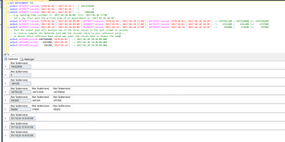

Important to understand is just that each timestamp statement in the response refers to the same REFERENCE datetime used in the input. So no matter which date you use: just be aware of the context.
I hope the screenshot here demonstrates what I meant. You can then store your reference date somewhere in your applications configuration and read it within the programm. Or you store it in the database as a CONST each application has to refer to. While you execute the programm and planning calls you have to know it...
