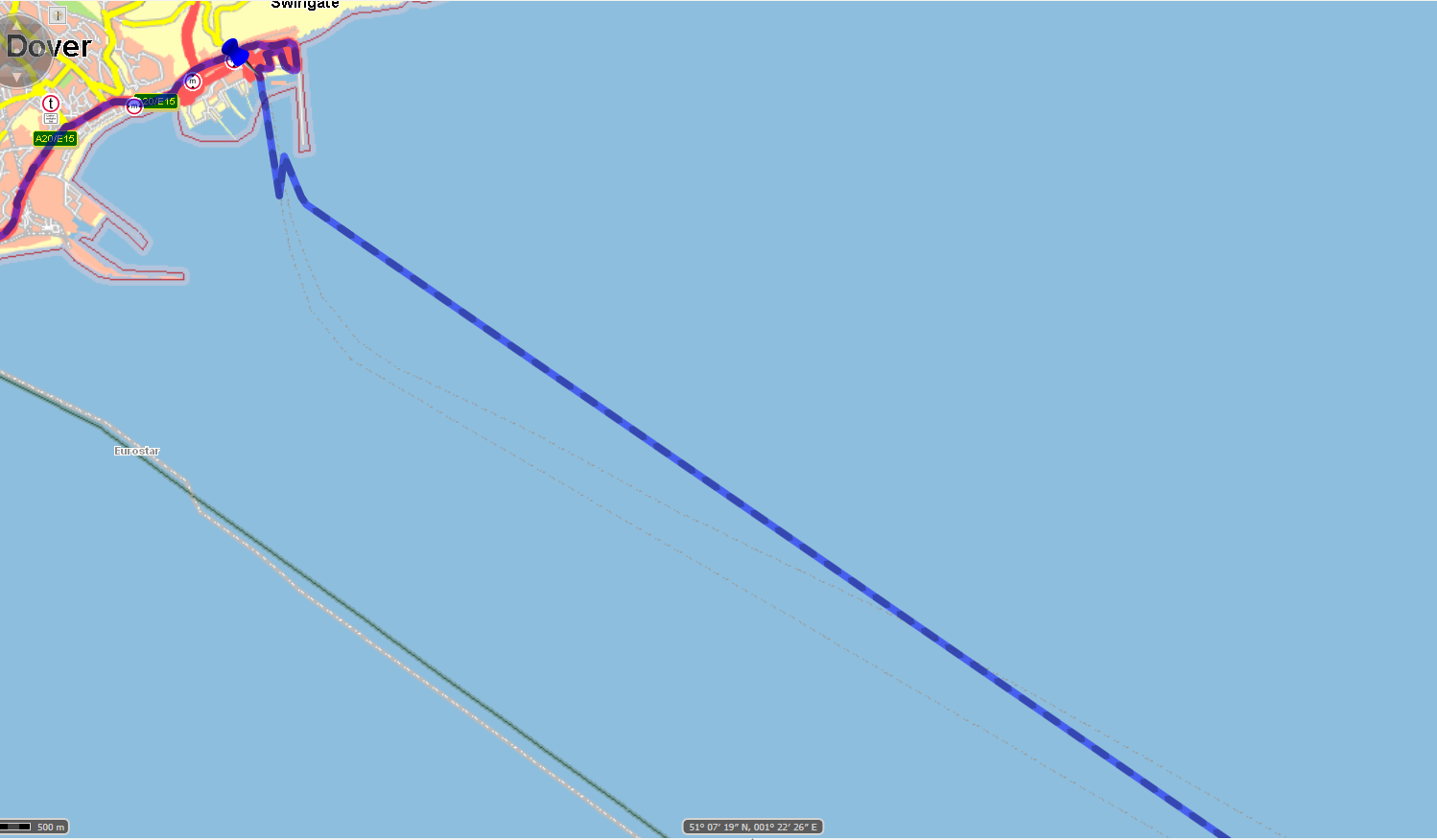

Hi, may I ask about route shaphe.
As you see below this route does'n cover ferry line. What does it mean. Is there any other ferry route which was not drawn?
What about that zigzak near Dover ?
Best Regards,
Krzysiek.

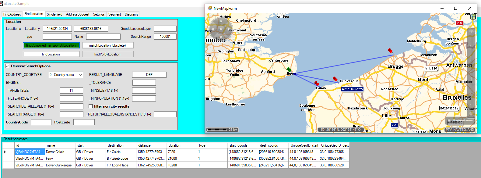

From what I checked with xLocate.findCombinedTransport there are 3 connections to the continent.
Sample created with xLocate testclient and findCombinedTransport. The polygon lines are just start- and end coordinates of the connections painted bay the testclient.
Let's wait for their feedback,
