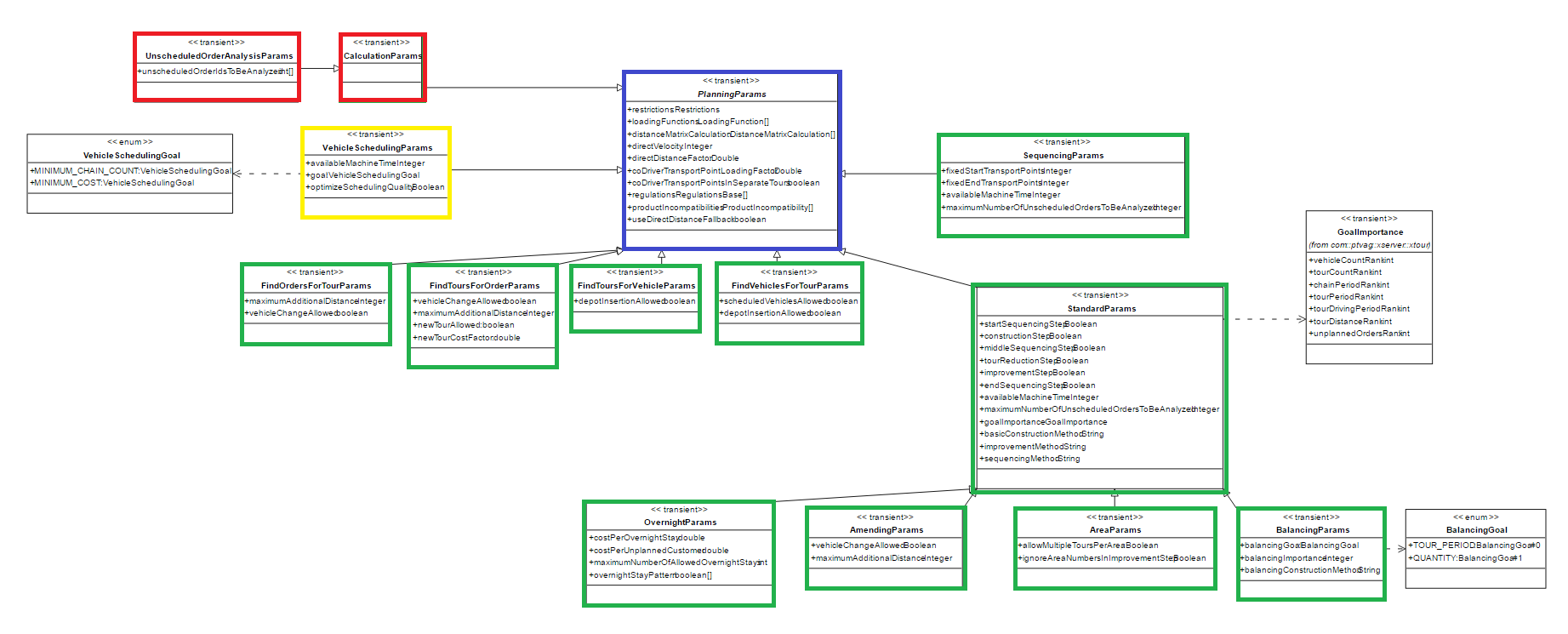

Quite often I describe tour optimization as "determine best attachment and sequence of orders (transport or tasks) to resources (trucks, cars) vehicles without violating constraints optimizing a goal" (ok, the sentence could be 5 times as long as it is including break- and rest rules and other influences ;-) )... the question is: what is the goal?
Some easy to understand approach is to separate the various classes.
blue: the base class that contains parameters required for all the scenarios<br />green: those scenarios create tours, change sequences and really optimize things<br />yellow: small optimization - doesn't change sequences but performs reassignments of tours as a whole<br />red: no optimization at all, just evaluation
