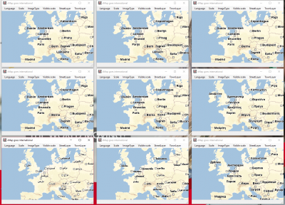

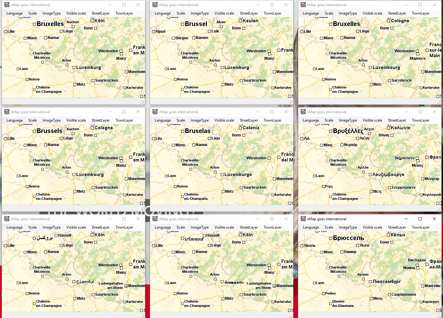

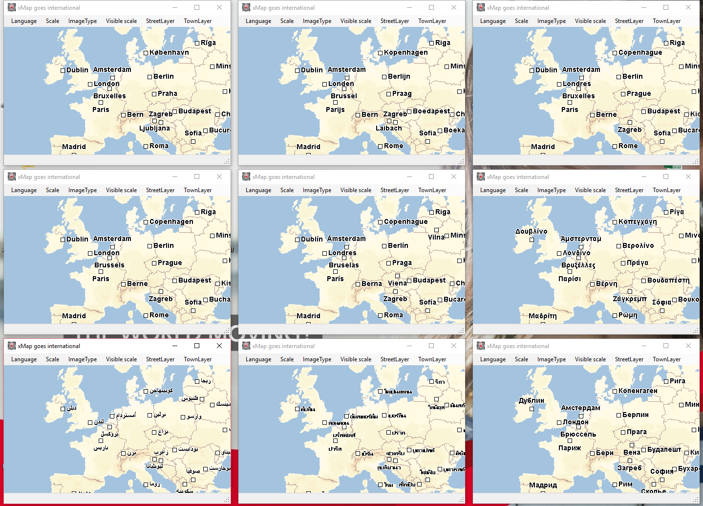

recent request of a prospect was "can you display maps in different languages?" (i.e. translation of city labels required)...
The answer is "yes". Looks like this:
some samples:<br />Default - Dutch - French<br />English - Spanish - Greek<br />Arabic - Thai - Russian-Cyrillic
some samples:
and zoomed out...
and zoomed out...
There are many more languages available, feel free to ask ;-)
