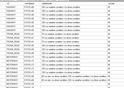

Re: Dynamic speed limits (weather based)
And here's just a screenshot taken via a testclient.
I performed a routing based on Europe City 2017.1H map and activated the SpeedInfos.
Structure of speed limits

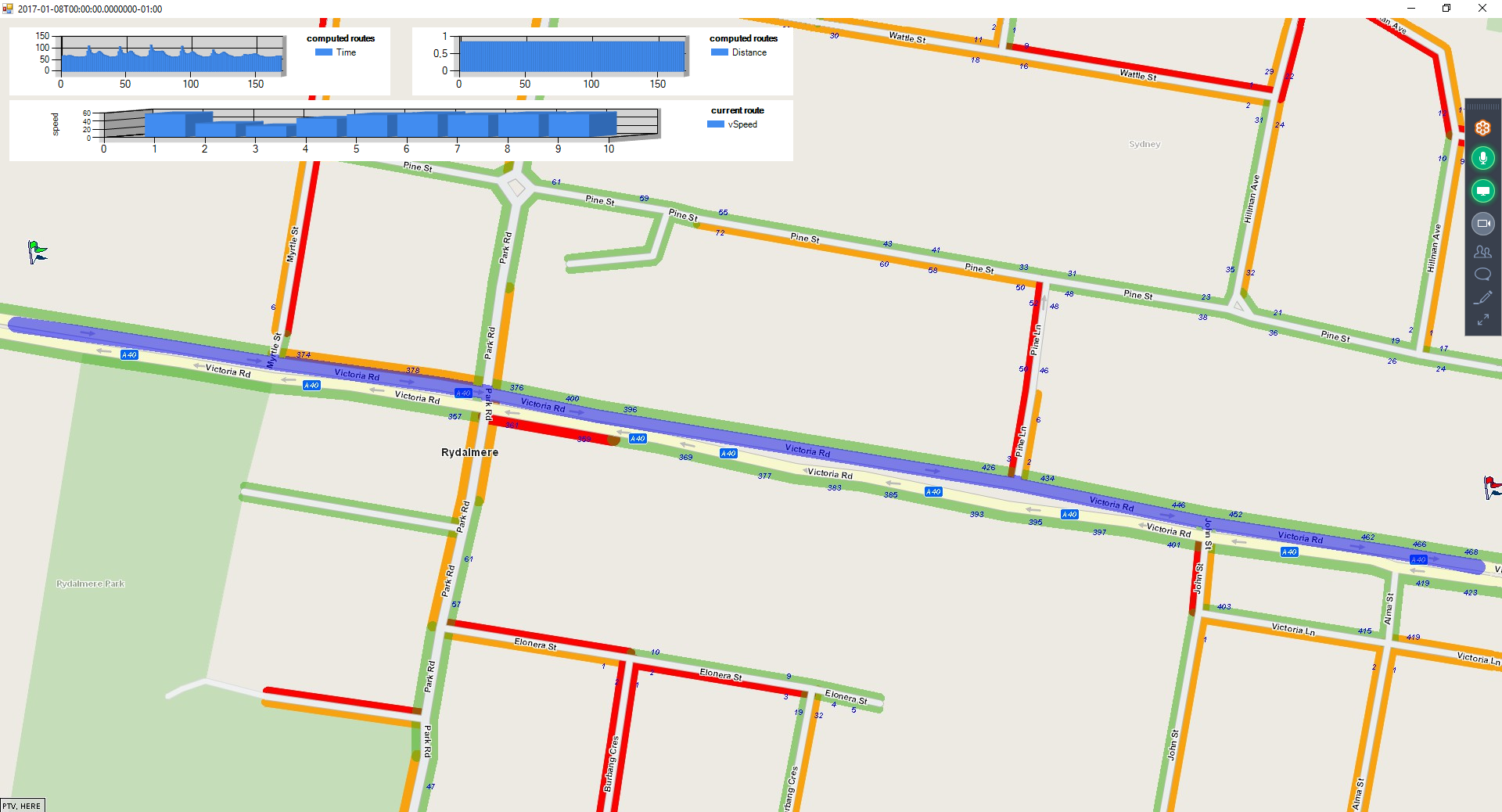

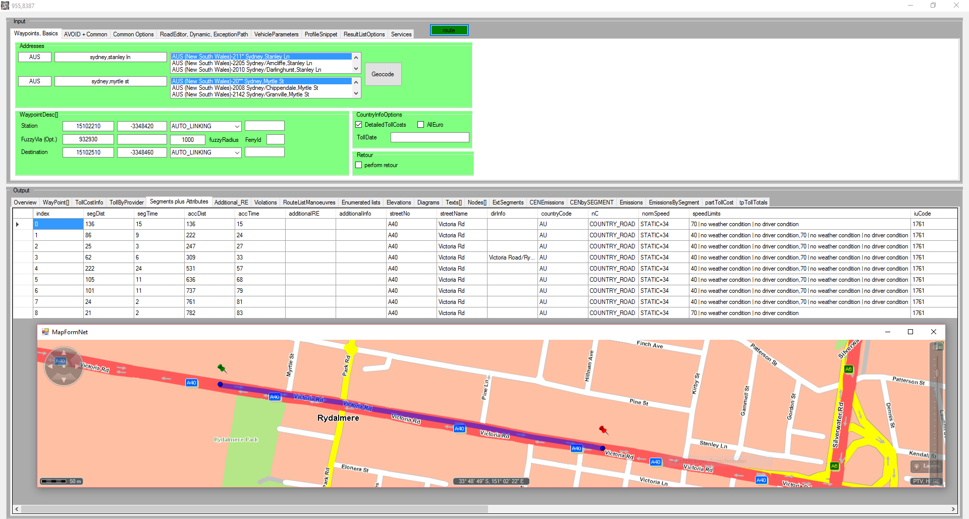

Posts: 3050
here is a screenshot demonstrating what is available over there...
Important: depends on the exact usecase - you shouldn't mix up historical speed values with limits.
Historical speed values based on PTV_SpeedPatterns.<br />The histograms show the driving time and period for each route from january 1st-january 8th, 00:00, 01:00, ..22:00, 23:00....
sample route with xRoute output
@Joost: you know the usecase - maybe you can add some comments...
Posts: 318
The speed limit data in our binary maps does not have all the properties we have available in our source data. Therefor you do not see a difference between the regular limit and the time dependent limit.
However: in your case I know that you have the source data licensed (spl and ls2 files). In the source data you can see witch limit is the time dependent limit by looking at the LIMITTIMECONDITION attribuut of a speed limit.
The data however stil does not show you the actual times for it. You could us historic traffic data to make estimates (Bernd example) but I would not rely on it.
PS For Australia we have a similar setup for truck limits as we have for the UK. Not available in our standard but is available on special request.
