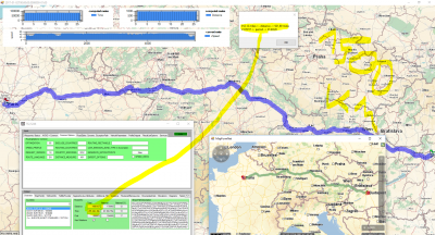

Of course this works only if the required speed is deriveable from those two segment values. If you doubt only in some LEVEL 3 roads we need something else... (ok, just reread your post - we are talking about "same level in same country") - Sample route Budapest to Paris: - Besides the traditional TIME ON SEGMENT depends on "16 speed values + NC" we also offer feature layers such as PTV_SPEEDPATTERNS. From my perspective the SpeedPatterns enable you to get a more realistic speed value and should replace the traditional style. And on a track of 1000km and more this approach will produce a fair average (and MIN period to MAX period isn't that big.

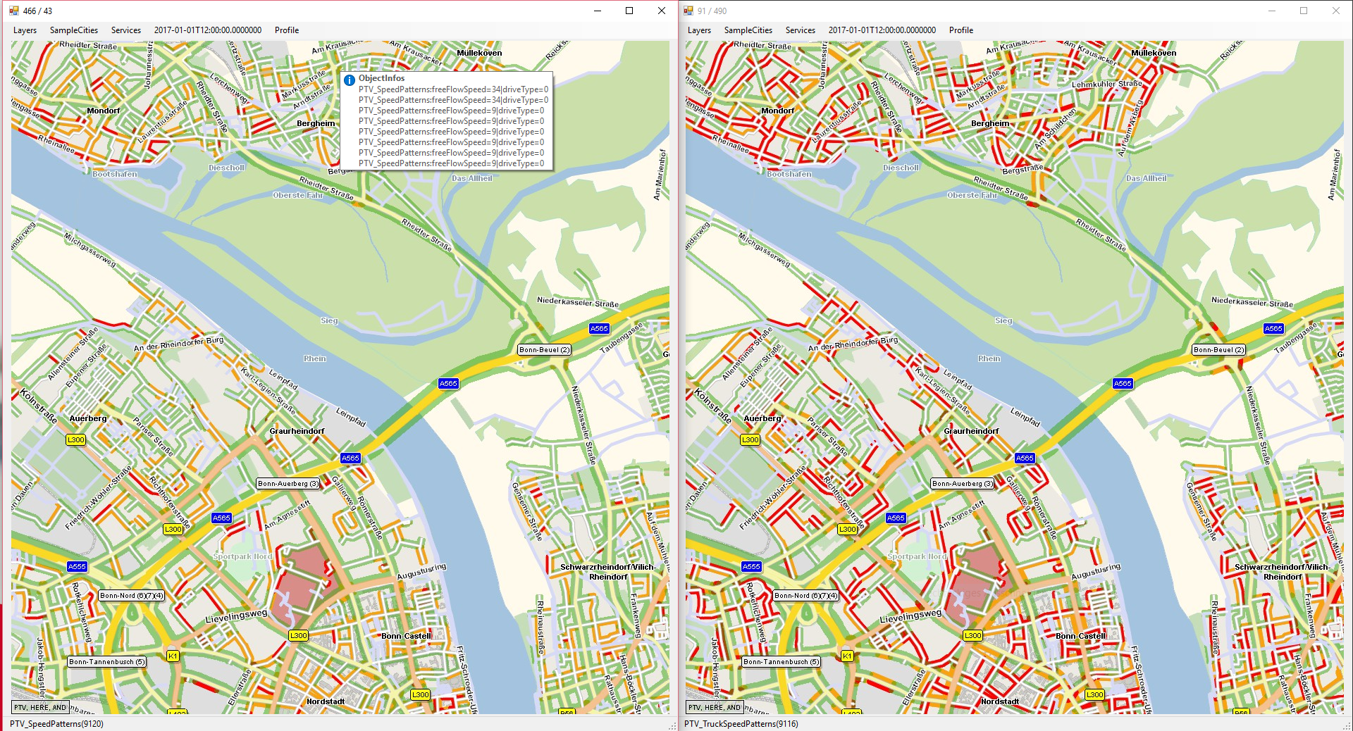

By the way: there are additional TRUCK based SpeedPatterns available...

the speed patterns are accessed as feature layers and can be downloaded via CustomerArea (and copied into the map).
The documentation contains several articles dealing with it.
http://xserver.ptvgroup.com/fileadmin/f ... lt.htm#Use cases/xRoute/OVER_Use_Cases_PTV_xRoute.htm%3FTocPath%3DUse%2520Cases%7CPTV%2520xRoute%7C_____0
Here's some XML snippet activating various feature layers:
you also have to specify the TIME and whether it is start or end of the route.
