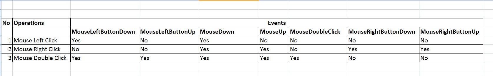

- How to invoke MouseUp Event on Mouse Left Button Click ?
We have implemented following functionalities -

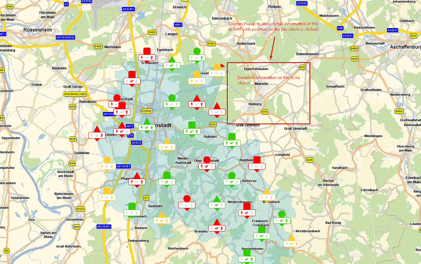

We need to implement following functionality -
1) Detailed Information Of Pin on Single Click
- We want to display the detailed information on MouseUp ?
Please see the screenshot attached of Mouse Click events.(MouseEvents.png)
Show custom popup for pin on mouse click for showing details

what about using OnMouseLeftButtonDown + ALT?

Re: Show custom popup for pin on mouse click for showing det
Thanks for the idea. We will try this and get back to you
