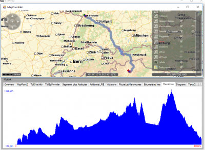

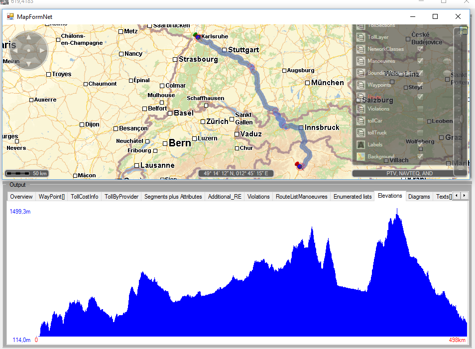

The routing methods in xRoute enable you to compute the altitude profile of a routing polygon.
Just request the ResultListOption.polygonElevations.
Sample route from Karlsruhe(Germany) to Bolzano (Italy).

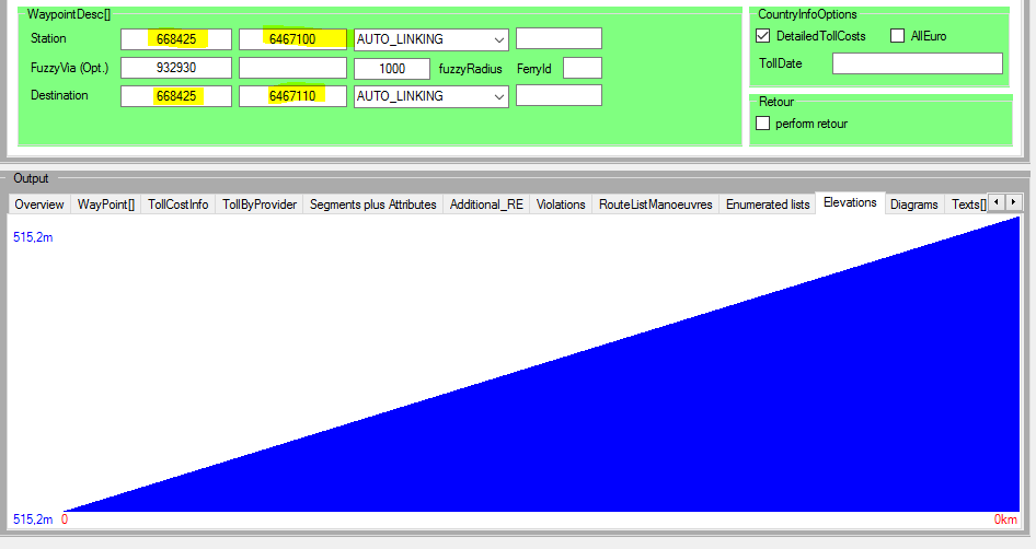

Minimal route: waypointdesc coordinates are almost equal. Elevations almost at same level.
