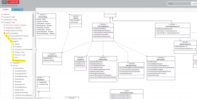

Is there a description about the rest rules included in xRoute ?
How to activate the french rules (or another country, if any?) for the driving time and the rest rules ?
And what about the day that it is forbidden for the trucks to drive? (saturday and sunday in France for example)

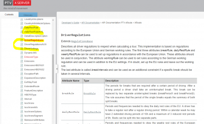

Hello Francois,
there are various so-called regulations available in xRoute. Some of them deal with European approaches (DriverRegulations) while others are describe the Australian style (DriverRegulationAUS).
The more concrete settings of those approaches are part of the rules.
This requires calculateAdvancedTour!
There are special rules reflecting the European laws (dailyRestRule, weeklyRestRule) but as far as I know there is no special rule given for the French market. Maybe you can use the existing ones and adapt their periods?
I don't know the official French law but if you give me a hint what you'd like to achieve I can try to find out how to solve it.
