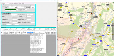

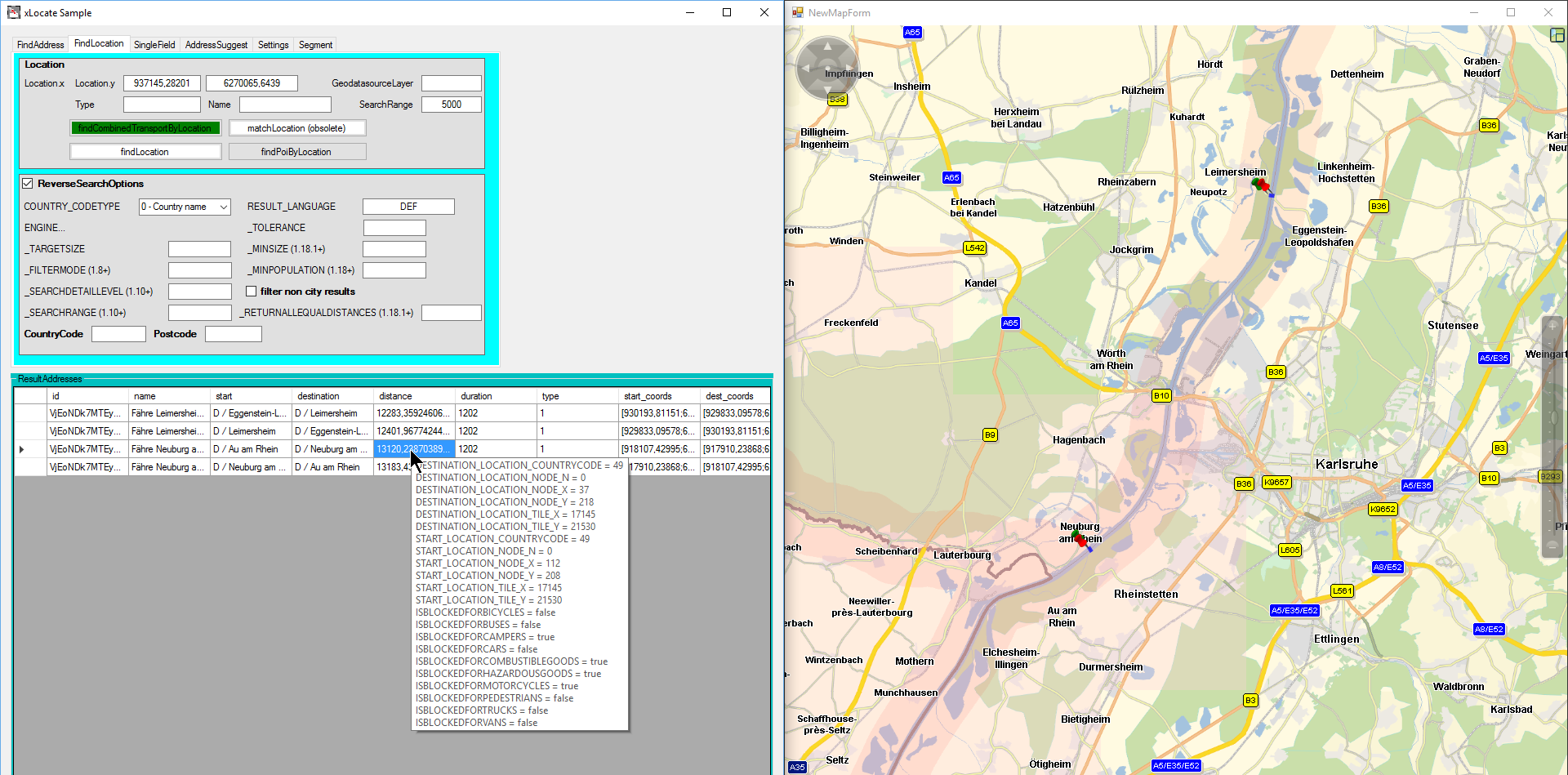

Besides this generic approach please take a look at xLocate.findCombinedTransportByLocation. It performs a nearest search.
