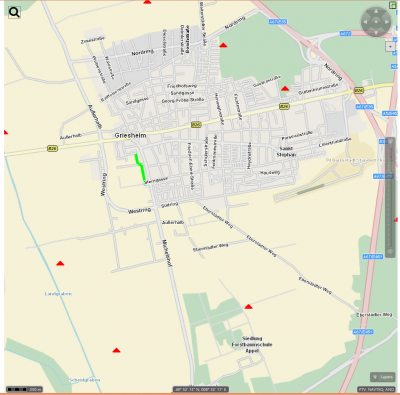

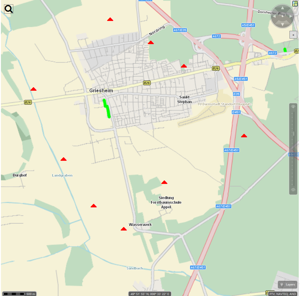

- We have xmap which shows points based on the coordinates provided to it.
- I want after showing the coordinates the map should zoom in by default.
- Please see the screen attached.
- By default (Xmap_default screen)
- Manually after zoom in(Xmap_After_Zoom_in)

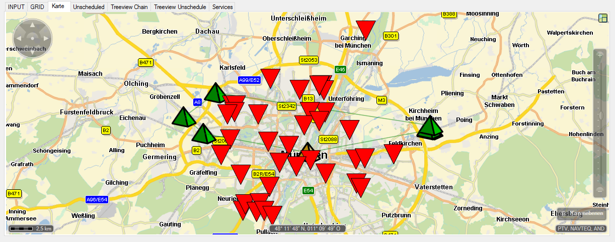

How about using the following approach?
I assume you know the coordinates of the bounding rect:
double north = dictTransportDepot.Values.Max(y => y.transportPoint.location.point.y);
double south = dictTransportDepot.Values.Min(y => y.transportPoint.location.point.y);
double west = dictTransportDepot.Values.Min(x => x.transportPoint.location.point.x);
double east = dictTransportDepot.Values.Max(x => x.transportPoint.location.point.x);
At least works fine with MERCATOR:
I just manipulated the initial coordinates (factor 0.1 is a value to play with):
double bufferH = (east - west) * 0.1;
double bufferV = (north - south) * 0.1;
north += bufferV;
south -= bufferV;
east += bufferH;
west -= bufferH;
formsMap1.SetEnvelope(new Ptv.XServer.Controls.Map.MapRectangle(west,east,south,north), "PTV_MERCATOR");
Initial image section applied by my sample source
