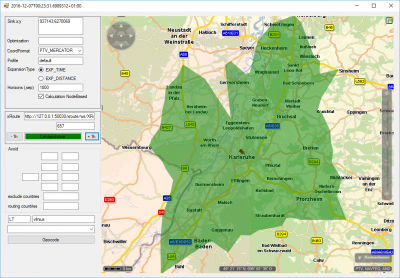

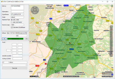

Furthermore I created some screenshots:
- Isochrone based on 00:00
- Isochrone based on 14:00
The snipped I used looks like this:
<Profile xmlns:xsi="http://www.w3.org/2001/XMLSchema-instance" xsi:noNamespaceSchemaLocation="http:///xroute/schema/XRouteProfile.xsd">
<Themes>
<Theme id="PTV_SpeedPatterns" enabled="true"/>
<Theme id="PTV_TruckAttributes" enabled="true"/>
</Themes>
</FeatureLayer>
<Course>
<AdditionalDataRules enabled="true"/>
<DynamicRouting limitDynamicSpeedToStaticSpeed="false"/>
</Course>
</Routing>
</Profile>
About the necessity of the DATETIME:
If you don't provide an explicit date we use the current system time.
