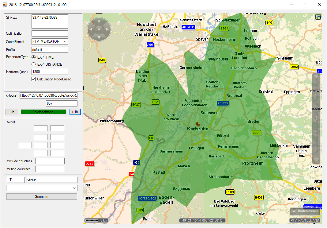

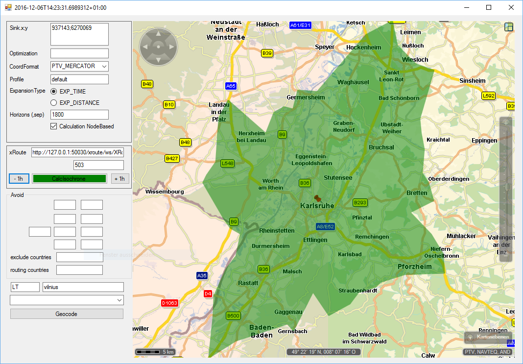

Furthermore I created some screenshots:
Isochrone based on 00:00
Isochrone based on 14:00
The snipped I used looks like this:

About the necessity of the DATETIME:
If you don't provide an explicit date we use the current system time.
