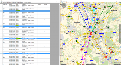

Here is the result
As you can see in the grid the server places an optimal 0:50 minutes break within each operating interval.
Looks great, doesn't it?
