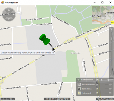

- Screenshot of a xServer.NET based application.
The control provides various gadgets such as
- zoom bar (right)
- coordinate bar (bottom center)
- magnifier (top right)
- navigation bar (top left)
- scale (bottom left)
