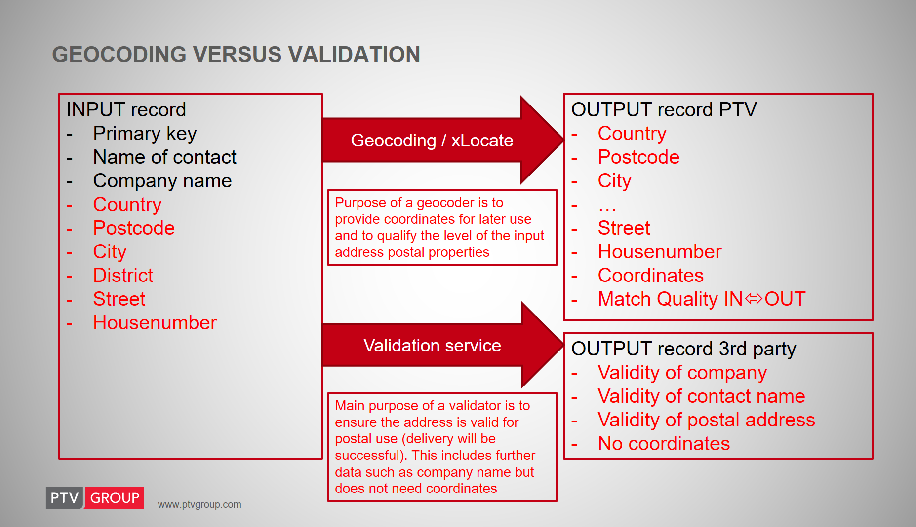

Re: Distinction between geocoding and address validation
Here's also a more visual description of the differences ;-)
Hope it helps
Difference between Address Geocoding and Address Validation
