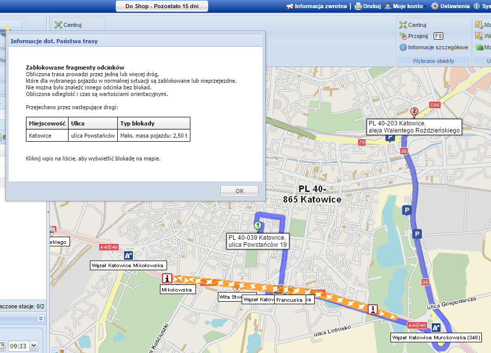

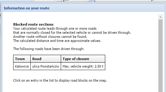

In a PTV Map&Guide internet there is a pretty nice info about route called "Blocked route section".
How can I gather this informations and where can I find it in ExtendedRoute?
In attachments there is an example of my request.
Best Regards,
Krzysiek

Re: Blocked route sections
thanks for your quick reply.
In spite of the fact that my request has proper truck attributes the response doesn't have any violations info.
I compered results with PTV Map&Guide internet with the same request (as much as possible). The response in https://xroute-eu-n-test.cloud.ptvgroup ... quest.html is without violation.
Please have a look at the response attachment.
There is something I'm missing here. Could you be so kind and tell mi what is wrong with my request ?
Best Regards,
Krzysiek

Krzysiek Paziewski
The difference is not because of your request, but a difference in map data. Map and guide is running on Here map data, xServer internet is running on TomTom map data. On your start street Here has the whole street blocked of for "heavier then 2,5 ton" while TomTom only has parts of the road blocked. If you execute you request on TomTom base map data our routing engine is able to find a way where it does not violate blockings, hence no violation warnings.
