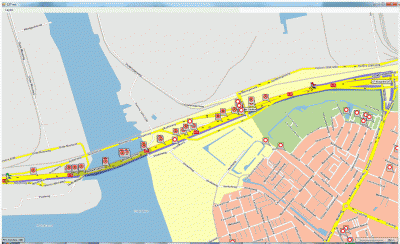

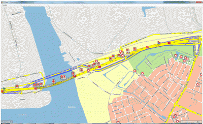

Shows the tunnel with a proper symbol!
Kind regards Bernd

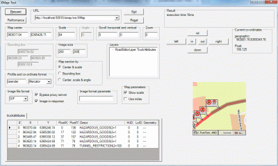

Meanwhile I also identified some non-100 tunnels. Here is an example:
The object infos (coordinates in Mercator, used map PTV_Europe_City_Map_Premium_2014_1T):
<ns2:LayerObject loId="0" hiId="0" descr="TUNNEL_RESTRICTION|2=110">
<ns2:pixel y="318.0" x="531.0"/>
<ns2:ref>
<ns1:point y="6769272.395629" x="481785.68898699805"/>
</ns2:ref>
</ns2:LayerObject>
So with this information you can drive through or pass the tunnel using the Road Editor:
ROADEDITOR_ADDITIONAL_OPTIONS=TUNNEL_RESTRICTION=110 (through)
ROADEDITOR_ADDITIONAL_OPTIONS=TUNNEL_RESTRICTION=140 (pass)

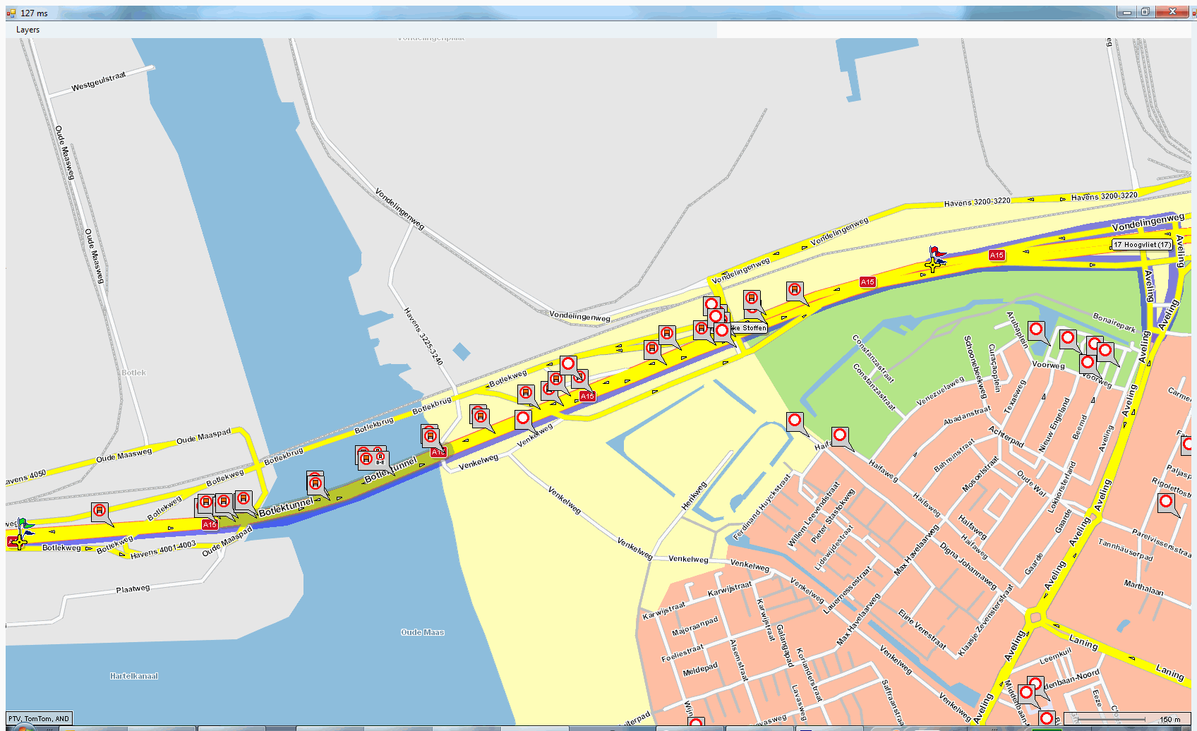

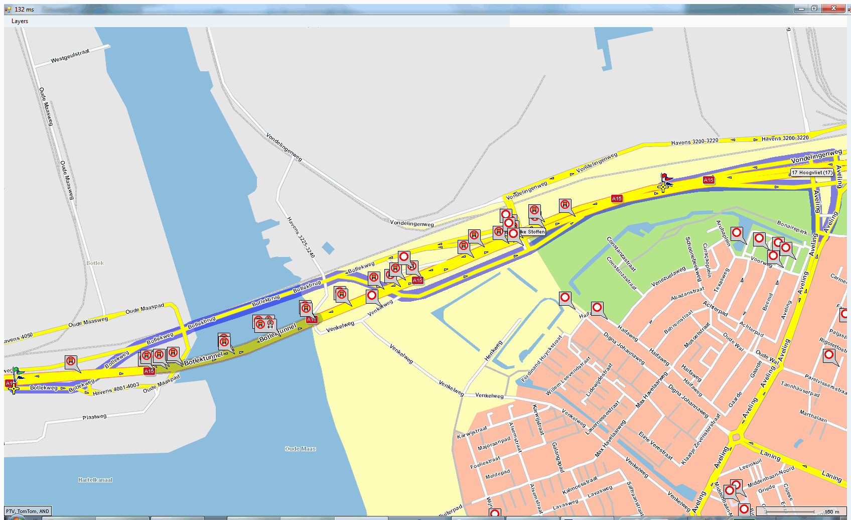

WaypointCoords:
480430 / 6769023 = Start
483757 / 6770017 = Destination
Regards from Germany,
Tunnel avoided, vehicle has higher code
Tunnel is used, vehicle has equal code
