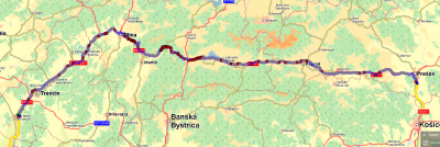

I would like to ask one question. How actual information about toll roads are in xServer.
My customer is the Slovak Republic told me that my application writes a bad toll distances. For road between Beck (17.878045,48.765518) and Prešov (21.260764, 48.950032) is a difference of nearly 100 kilometers. xServer gives toll distance 208 km, but according to the official site to calculate tolls on Slovak (
https://www.emyto.sk/) is a toll distance 308 km. Both calculations allow for driving on the same roads for a truck 40 tons EURO5.
When I checked the calculated data and some of the roads xServer not identified as a toll, even though in reality they are toll roads.
Thank you for your help.
Vladimír

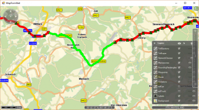

Re: Toll data
Posted: Fri Sep 23, 2016 7:19 am
Hello Vladimir,
The test client is available here (link might not be available in a few months):
https://ptvbox.ptvgroup.com/index.php/s/TbuUGwwjWXZOcfy
The list of sections is available in the lower result tabs.
Furthermore the client shows several layers based on the segment attributes:
- one layer with all segments "hasTollCar"
- one layer with all segments "hasTollTruck"
- one layer
The toll layer itself is a bit more complex:
My current definition of "segment has toll" is based on:
private bool segmentHasToll(RouteListSegment rls)
if (rls.segmentAttr == null)
return false;
else
{ SegmentAttributes sa = rls.segmentAttr;
return (sa.hasExtraToll || (sa.hasNamedTollSpecified && sa.hasNamedToll) || sa.hasTollCar || sa.hasTollTruck || sa.hasVignetteCar || sa.hasVignetteTruck);
- - green triangle: toll section starts
- red triangle: toll section ends
- red / green line: segment attributes have toll or not
Attention: some info is based on the segment attributes (not on the vehicle and the concrete routing!): hasTollCar, hasTollTruck, TollLayer.
Other info is based on the vehicle (and therefore the concrete routing!): sections.
PS: feel free to mention further layer structures you'd like to see for debugging
Re: Toll data
Posted: Tue Feb 14, 2017 10:19 am
by VPlachy
Hello Bernd,
I tried, if this problem has been fixed toll and I found that a correction toll data was performed but even so there is still a mistake.
The figure shows a section where the toll does not count in the calculation, but in reality it is a road fee.
Vladimír
Re: Toll data
Posted: Sun Feb 19, 2017 10:10 am
Hello Vlad,
Which map do you use?
- Based on 2017.1H
My local installation seems to return TOLL for the part you mentioned.
