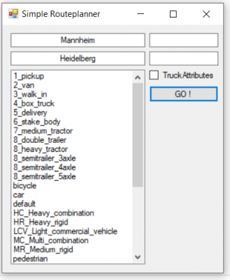

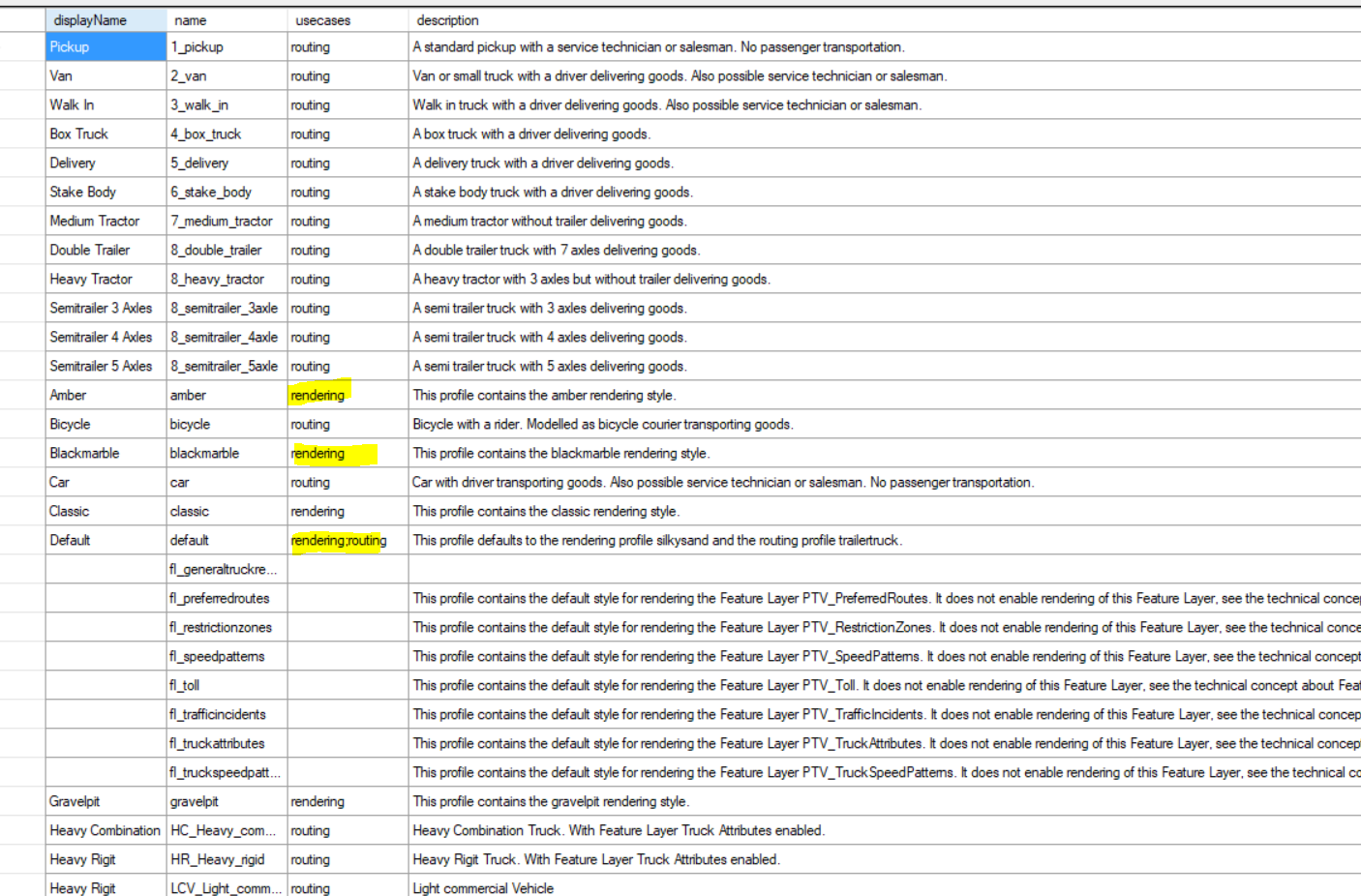

By the way: the xServer 2 will offer the possibility to gather the available profiles via API call.
And the result objects will provide properties that enabe you to filter them by usecase so you can create such elements:
ServerConfigurationRequest config_request = new ServerConfigurationRequest
resultFields = new ConfigurationResultFields
profilesSpecified = true,
profiles = true
ServerConfigurationResponse config_response = xruntime.getServerConfiguration(config_request);
lbxStoredProfile.Items.AddRange(config_response.profiles.Where(usecase => ((usecase.useCases != null) && (usecase.useCases.Contains("routing")))).OrderBy(u=>u.name).Select(p => p.name).ToArray());Bernd
