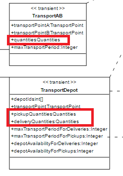

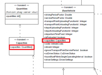

Quantities are related to Vehicles...
and orders...
and orders...
Let's start with an order based on the properties mentioned in the example: "weight, volume, turnover".

Now look at the vehicle.
Example:
Quantities of the vehicle new int[]{ 700 , 5 , 15000 }. Such a vehicle pattern would be able to transport Order #1 and Order #2 but NOT at the same time (because the combined array exceeds at least one of the components.
In other words: a set of orders can be handeled at the same time on a vehicle if every aggregated component of the orders is lower equal than the assigned component of the vehicle.

And there is even more functionality available: check the loading patterns! A vehicle is not only able to deal with a single QUANTITIES pattern but with several of them. If at least one of the vehicles patterns (each one reflects current physical conditions depending on current setup) matches the orders: DEAL! Only thing to be considered: the pattern of the vehicle can't change within a tour (this might be possible in reality but not in the API).
