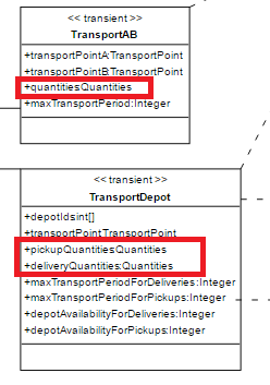

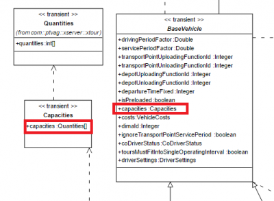

Quantities are related to Vehicles...

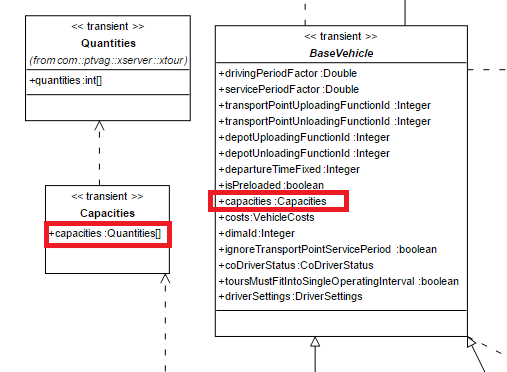

and orders...
and orders...
Let's start with an order based on the properties mentioned in the example: "weight, volume, turnover".
That means you have to work with an int[3] array in the context of a planning task (single transaction).
  • Order #1: 500kg, 5 Pieces, 10000€ so you can use int[3]=new int[]{ 500 , 5 , 10000 }
  • Order #2: 700kg, 3 Pieces, 15000€ so you can use int[3]=new int[]{ 700 , 3 , 15000 }
  • Both orders at the same vehicle at the same time? that's simply like new int[]{ 1200 , 8 , 25000 }. Just add the components of the array
Now look at the vehicle.
Example:
Quantities of the vehicle new int[]{ 700 , 5 , 15000 }. Such a vehicle pattern would be able to transport Order #1 and Order #2 but NOT at the same time (because the combined array exceeds at least one of the components.
In other words: a set of orders can be handeled at the same time on a vehicle if every aggregated component of the orders is lower equal than the assigned component of the vehicle.

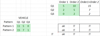

I created a little testtool that shows how to deal with patterns.
Feedback welcome. Feel free to play with the green cells and try to understand the output of the "!!" or "ok" cells in italic.
LOADING PATTERNS.xlsx
Test sheet
