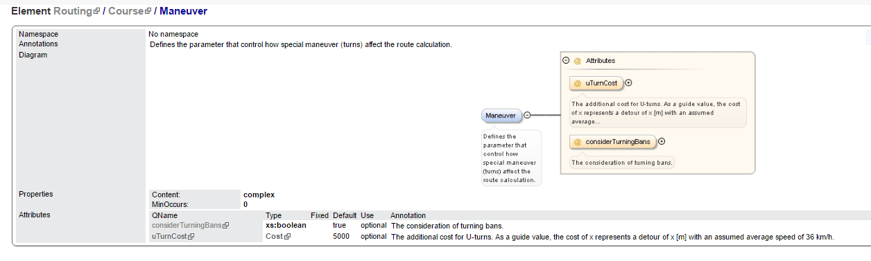

We would like to avoid left turns as many express companies have that as a policy in the USA since it is faster and introduces less accidents. I could not find this option in the xRoute profiles. Does one exist?
- Posts: 3040
Re: Maneuver LeftTurnCost exists?
Hello Jan,
know that the usecase "avoid left turns" is quite common in the parcel delivery business but unfortunately the current routing interfaces do not provide a penalty for left turns. We only support penalty for u-turns.
I forwarded your request to DEV, but I'm realistic: I do not expect a quick solution for that. Not even sure whether the upcoming features in autumn deal with it.
