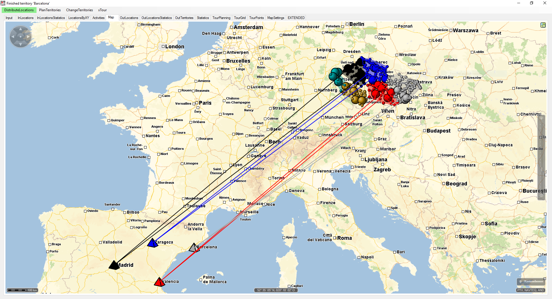

overall visualization of 6 sales reps and their 6 service areas. Sevilia/Malaga are even further away from the simulated czech customers than the sales reps in Barcelona and Zaragoza.

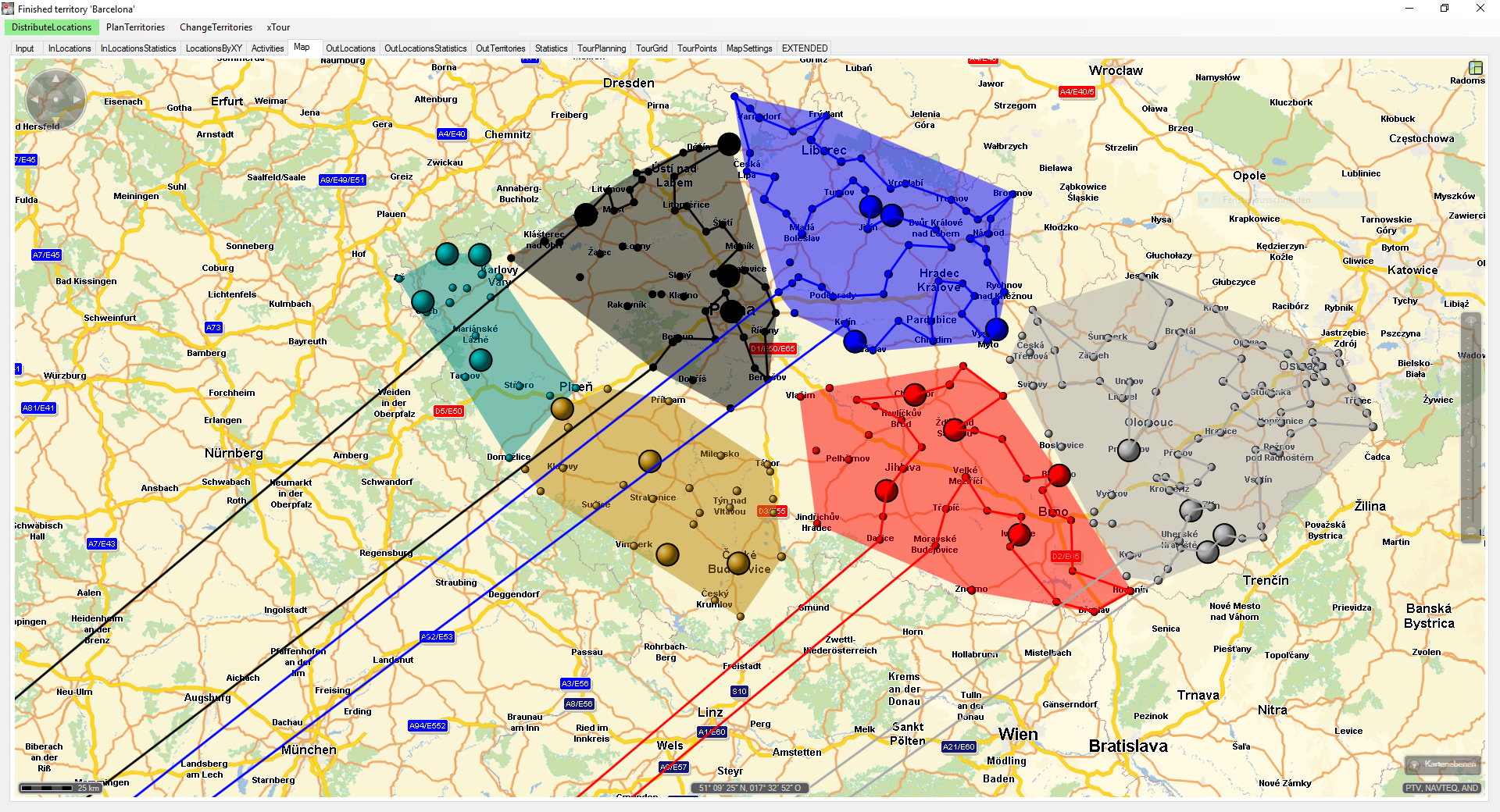

As you can see in the close view the blue,red, black and grey sales reps manage to visit some of their customers (not 100%) while the golden and the green sales reps do not visit anybody.

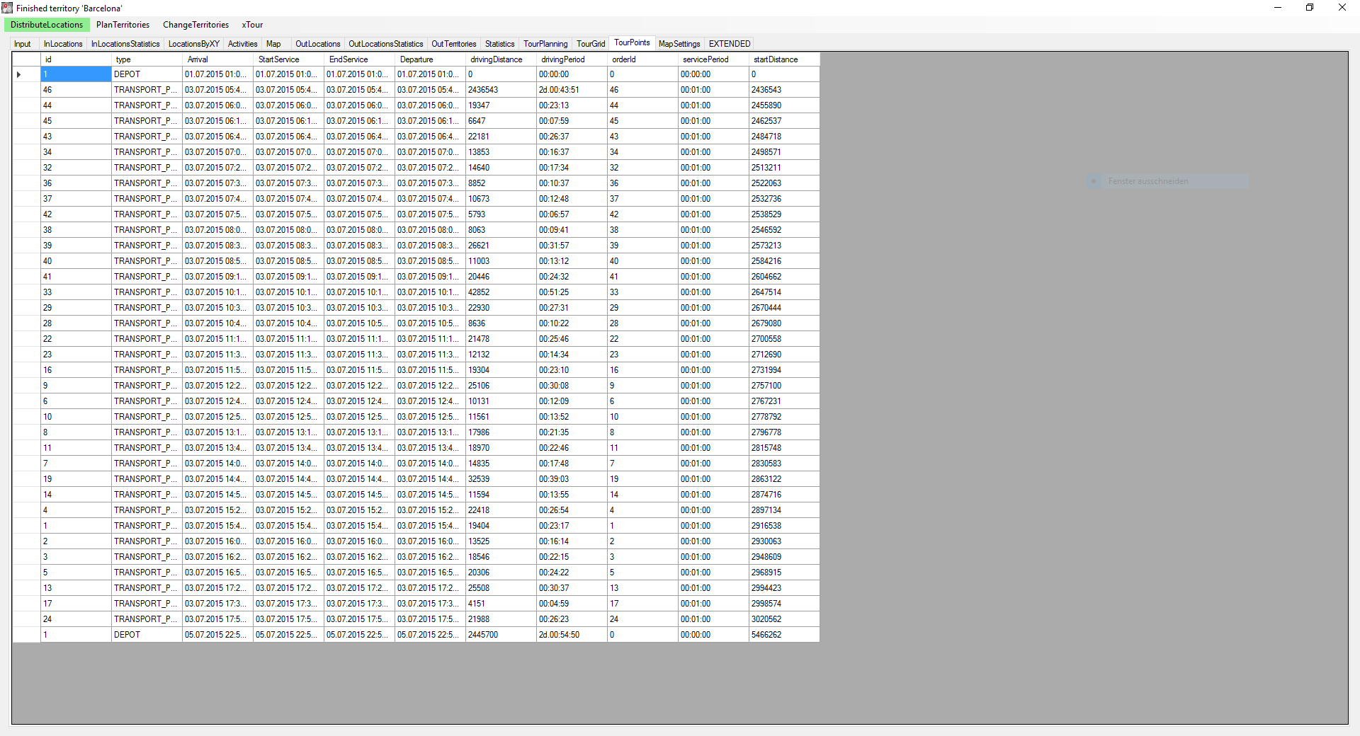

Here is the schedule for the BARCELONA sales rep (grey). As you can see in the second row the transfer from Barcelona to the grey area requires more then 2 days of driving so there is only a slim budget of time available for the WEDNESDAY visits.<br />I achieved this by setting the costs per unscheduled customer to a very high value (100000) while the costs per distance / period are rather low (1).
