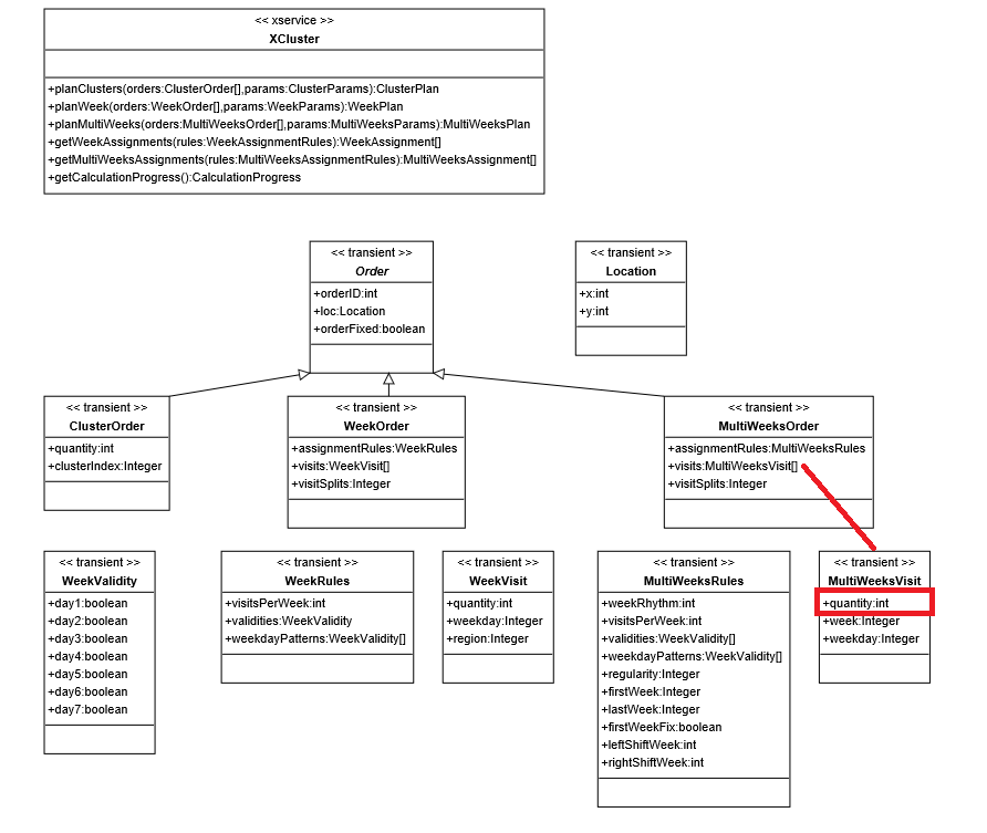

Check the quantity property of the MultiWeeksVisit class.

just look at this..
