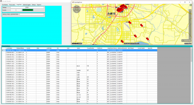

About
geocoding
- Shows some geocoder output in the grid and in the .NET control based map. As we mentioned during the webinar the current implementation of the service supports single field search (finndAddressByText). As you can see in the grid, the address data is returned in chinese character sets.

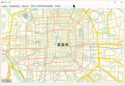

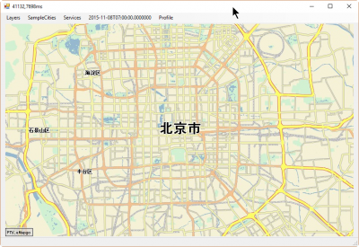

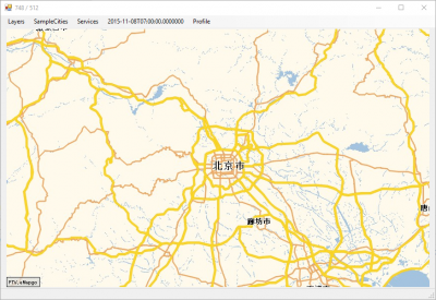

About
generic mapping

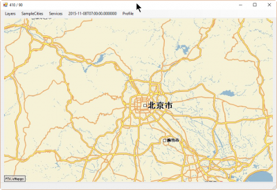

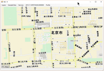

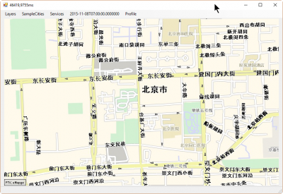

- Profile = sandbox
Scale = close
- Profile = sandbox
Scale = medium
- Profile = sandbox
Scale = large
- Profile = silkysand
Scale = close
Scale = medium
Scale = large

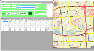

About
routing:
- Generated with xRoute.calulateRoute
About

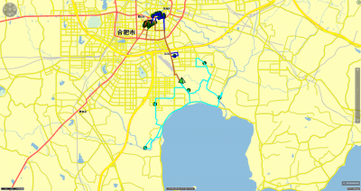

tour planning:
- Tour optimization based on xTour.planBasicTours
