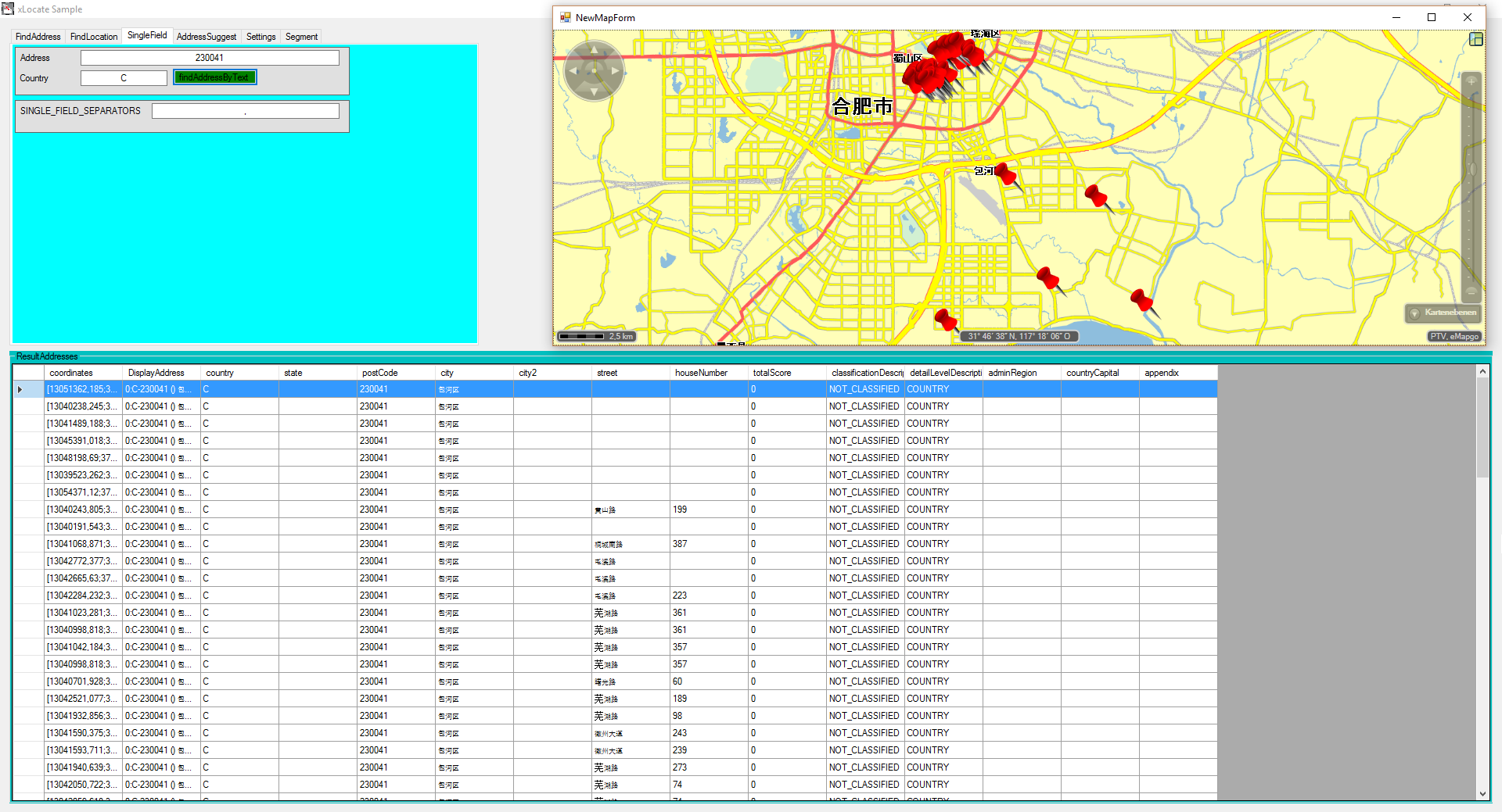

About geocoding
Shows some geocoder output in the grid and in the .NET control based map. As we mentioned during the webinar the current implementation of the service supports single field search (finndAddressByText). As you can see in the grid, the address data is returned in chinese character sets.

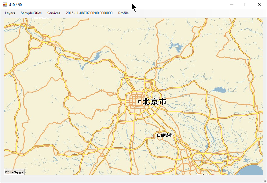

About generic mapping
Profile = sandbox<br />Scale = close
Profile = sandbox
Scale = close
Profile = sandbox<br />Scale = medium
Profile = sandbox
Scale = medium
Profile = sandbox<br />Scale = large
Profile = sandbox
Scale = large

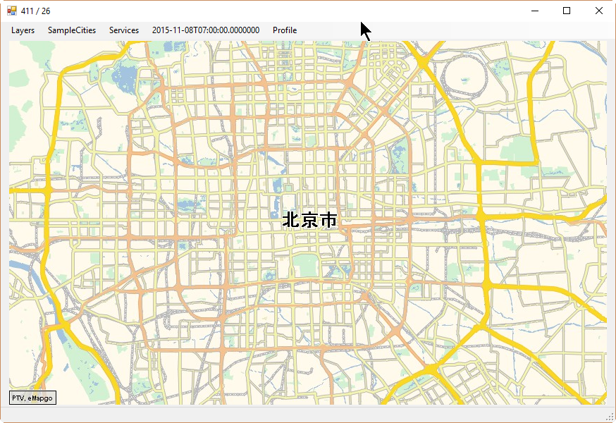

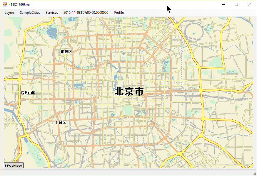

Profile = silkysand<br />Scale = close
Profile = silkysand
Scale = close
Profile = silkysand<br />Scale = medium
Profile = silkysand
Scale = medium
Profile = silkysand<br />Scale = large
Profile = silkysand
Scale = large

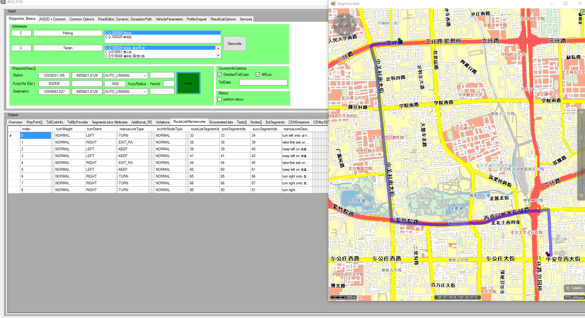

About routing:
Generated with xRoute.calulateRoute

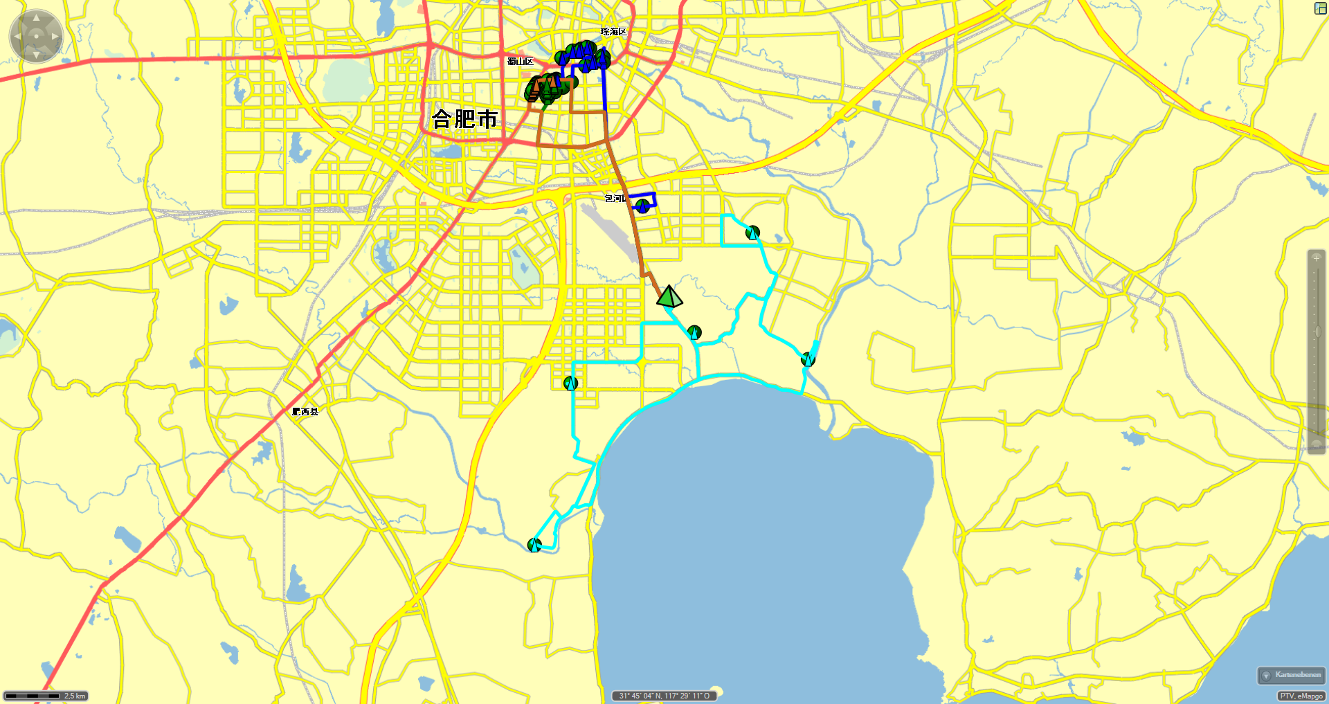

About tour planning:
Tour optimization based on xTour.planBasicTours
