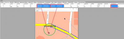

how about this approach:
-  Use the RoutingOption.GENERATE_EXTWAYPOINTS=TRUE
-  This will extend the response and tell you the LOCATION coordinate and the so-called MATCH coordinate for each waypoint.
-  With this additional information you can paint the missing connection between input coordinates and the routing polygon.
			-  The image shows the distance between LOCATION COORDINATE and MATCH COORDINATE. If necessary you can paint this airline connection.

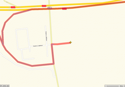

				And here is a little example, the yellow cross is the input coordinate.
The red line is your goal.
			-  Little proof: the blue line is the polygon returned by the server.
The red line is the overlay of POLYGON and LINKING DISTANCE. Looks fine in my eyes.
