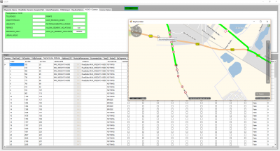

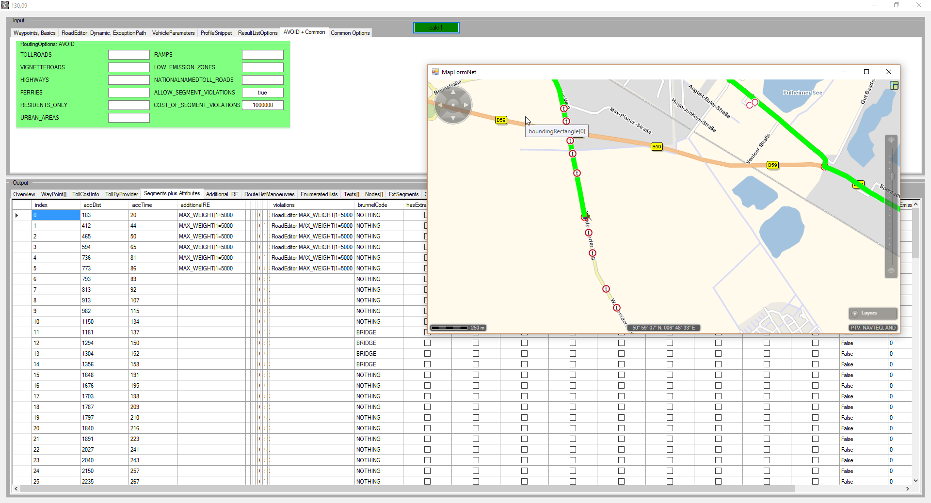

Example situation near Leverkusen. The street is restricted due to max weight 3.5t. The vehicle's weight is set to MAX_WEIGHT=7500.<br />Applying the TruckAttributes without accepting violations (ALLOW_SEGMENT_VIOLATIONS=false) causes errors. Setting the ALLOW_SEGMENT_VIOLATIONS=true and COST_OF_SEGMENT_VIOLATIONS=100000 finds a way to the start / destination and returns &quot;there have been violations!&quot; in the response.
Applying the TruckAttributes without accepting violations (ALLOW_SEGMENT_VIOLATIONS=false) causes errors. Setting the ALLOW_SEGMENT_VIOLATIONS=true and COST_OF_SEGMENT_VIOLATIONS=100000 finds a way to the start / destination and returns "there have been violations!" in the response.
