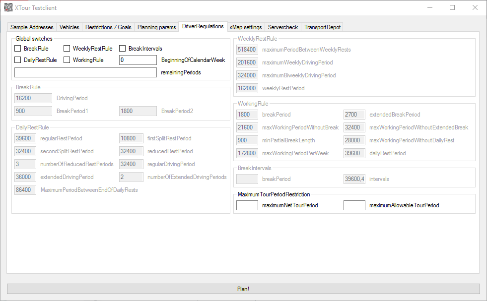

please have a look at the classes DriverRules and DriverSettings: They offer various strategies of how to include breaks into the tours of drivers. While some of them are based on legal constraints (WorkingRUle, DailyRestRule, WeeklyRestRule) others are more "some customers use the same scheme"... (e.g. BreakIntervals).
http://xserver.ptvgroup.com/fileadmin/f ... %7C_____25
Testclient demonstrating the various break mechanisms.
While you specify the DEFINITION of the DRIVER REGULATION rules as part of the PlanningParams class (or subclasses) the switches for enabling / disabling those rules for a vehicle are located in the vehicles DRIVER SETTINGS.
