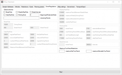

Testclient demonstrating the various break mechanisms.
While you specify the DEFINITION of the DRIVER REGULATION rules as part of the PlanningParams class (or subclasses) the switches for enabling / disabling those rules for a vehicle are located in the vehicles DRIVER SETTINGS.
