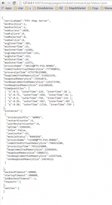

Re: API to check xSever module connection
Hello Prakash,
there are different strategies available of how to monitor a server. They are described here:
http://xserver.ptvgroup.com/fileadmin/f ... n%7C_____3
One potential approach looks like this:
Sample call via JSON (xMap)<br />http://127.0.0.1:50010/xmap/pages/moduleCommand.jsp?status=json
