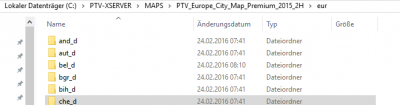

just a view into my map folder
Depending on the data that is located in that directory you can use it for various detail levels

Imagine you received a serial number based on D-A-CH license. After the installation process you will find the following directories in your map folder:
  • DEU_D, CHE_D, AUT_D - these folders contain the DETAILED information for Germany, Switzerland and Austra. "_D" indicates the DETAILED level.
  • lot of other folders per so-called INTEGRATION UNIT, e.g. AND_T, BEL_T, ... "_T" indicates the TRANSIT level
  • and some more generic files in the root folder
