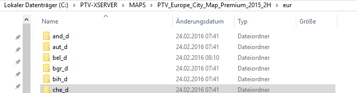

maps.path=C:/PTV-XSERVER/MAPS/PTV_Europe_City_Map_Premium_2016_1H
just a view into my map folder
Depending on the data that is located in that directory you can use it for various detail levels
  • detailed = highest level of information, e.g. small streets and house numbers
  • transit = superficial level of information, e.g. just the major roads (highways)
Furthermore the available "universe" depends on the installation media that was used for the map setup:
Usually customers receive the Europe City Premium map DVDs which contain the data for whole Europe.
  • detailed information for each country
  • some generic data such as ferry layers, emission data and other stuff.
During the setup process you have to enter the serial number and this number will trigger the extraction of the data depending on the license context.
EXAMPLE:
Imagine you received a serial number based on D-A-CH license. After the installation process you will find the following directories in your map folder:
  • DEU_D, CHE_D, AUT_D - these folders contain the DETAILED information for Germany, Switzerland and Austra. "_D" indicates the DETAILED level.
  • lot of other folders per so-called INTEGRATION UNIT, e.g. AND_T, BEL_T, ... "_T" indicates the TRANSIT level
  • and some more generic files in the root folder
For customers using xServer INTERNET the data behind the services depends on the service URL: I hope this info gives you a better understanding of the mapping topic in general. If not: let me know and I'll extend the example.
