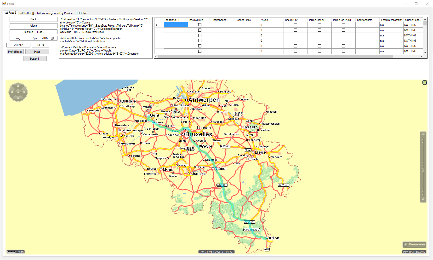

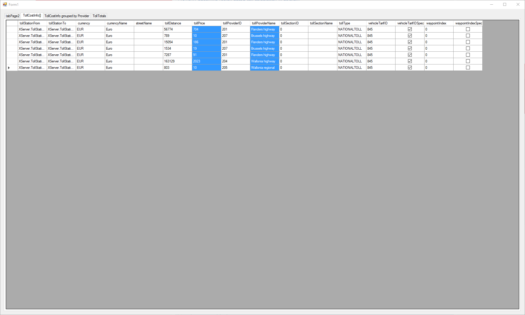

And here are some sample screenshots produced by a testclient.
Screenshot of a testclient with a route through Belgium. Date is 1.4.2016

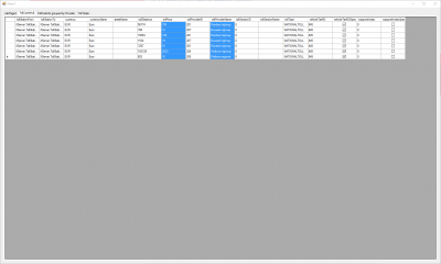

List of all the detailed toll sections. You can see the prices and providers for each section.

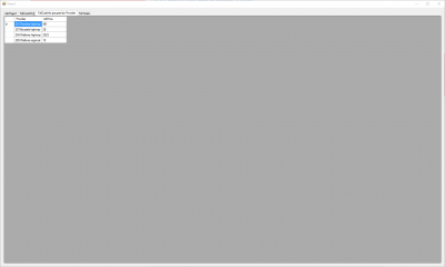

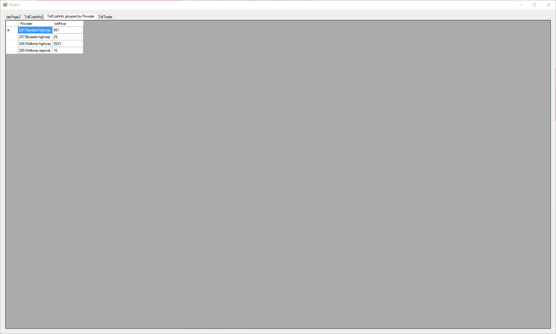

List of the net prices grouped by the TollProvider IDs. You can multiply the net prices with the tax tarifs(Provider)

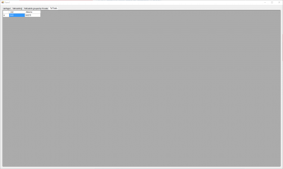

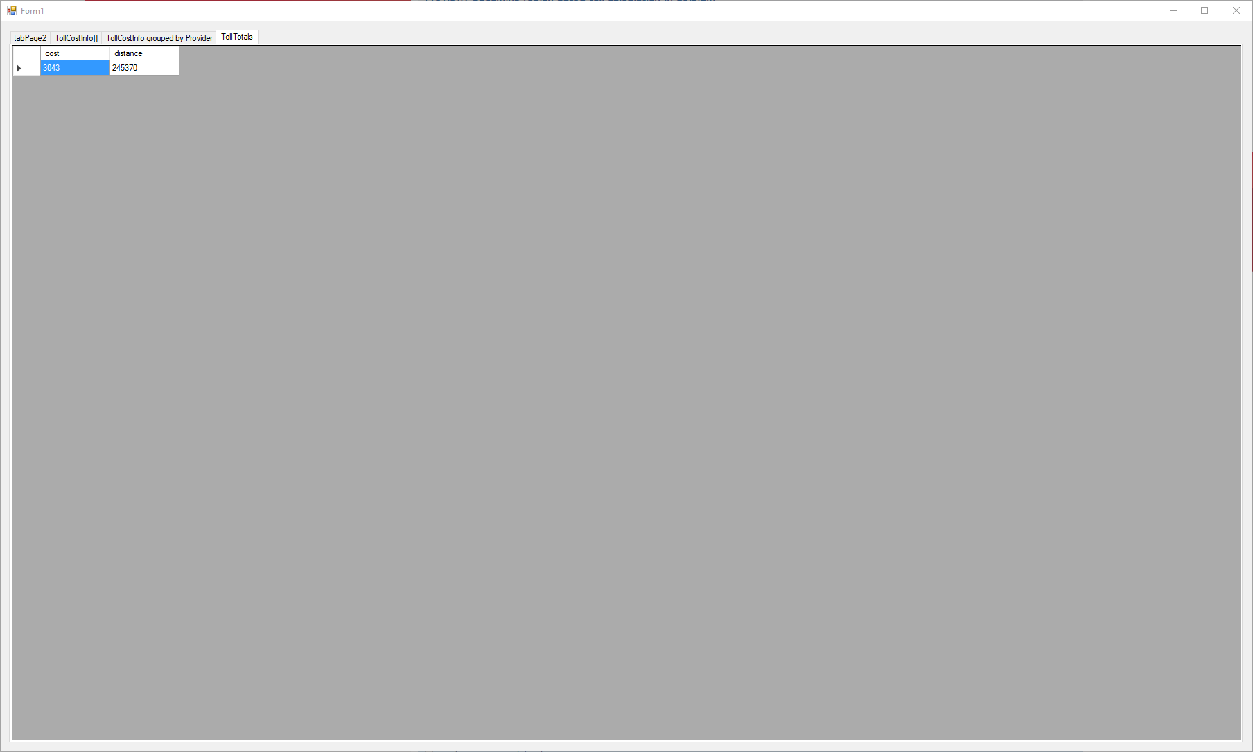

Just the toll totals. As the sample route is based on two belgium waypoints the list is based on a single element.
