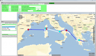

Furthermore the OPTIMIZATION should use values between 20 and 80 percent... values outside this interval may cause strange side effects such as ferry hopping
OPTIMIZATION = 0 leads to strange shortcuts...  total distance from Barcelona/Spain to AThens/Greece: 550km ??? 70 hours driving period? No: we spend most of the track on ferries...
