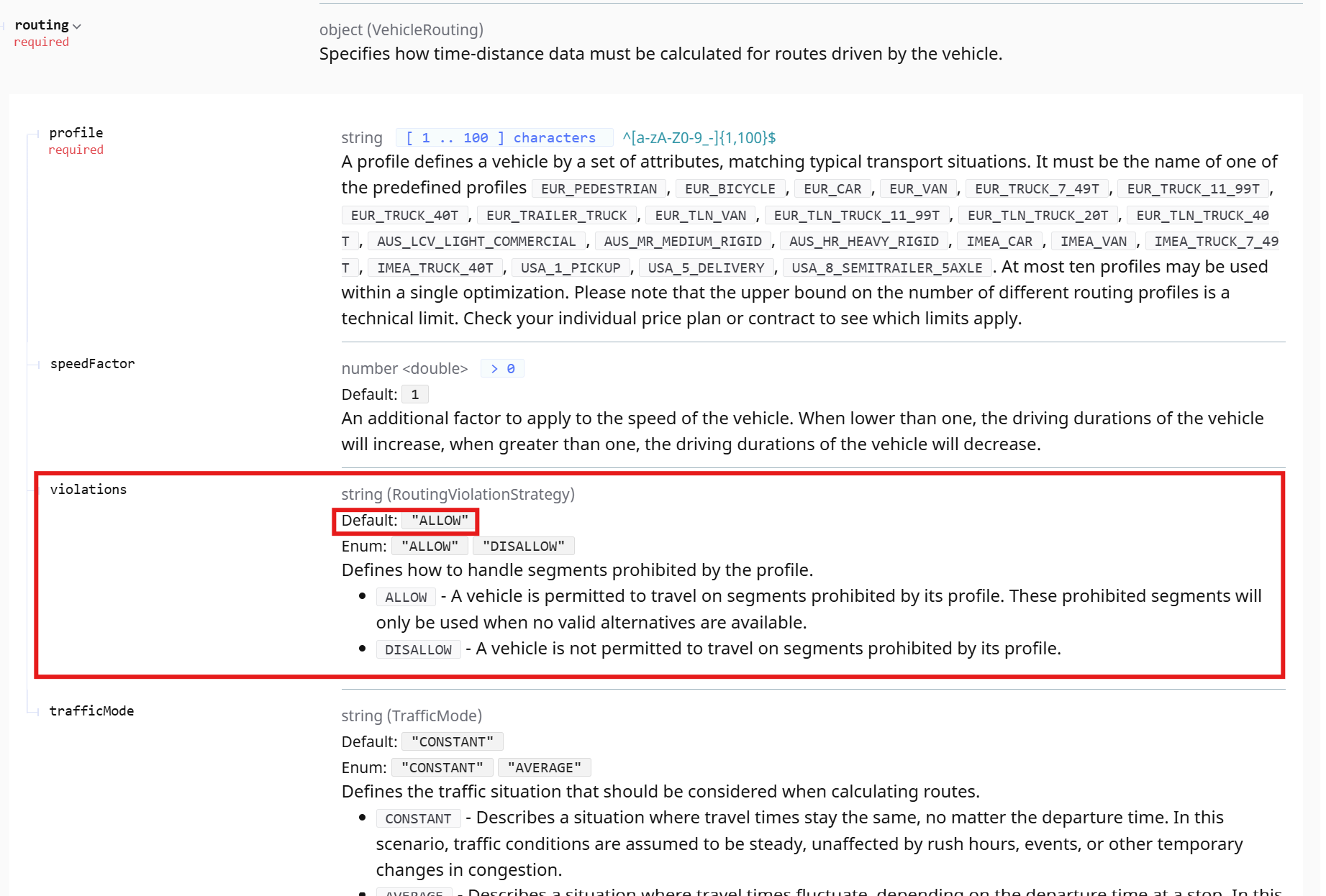

Without knowing the details I anticipate that the vehicle profile you used allows violations to appear (afaik this is the default)
If this assumption is correct you can forbid such kind of a result by assigning allowViolations to false.

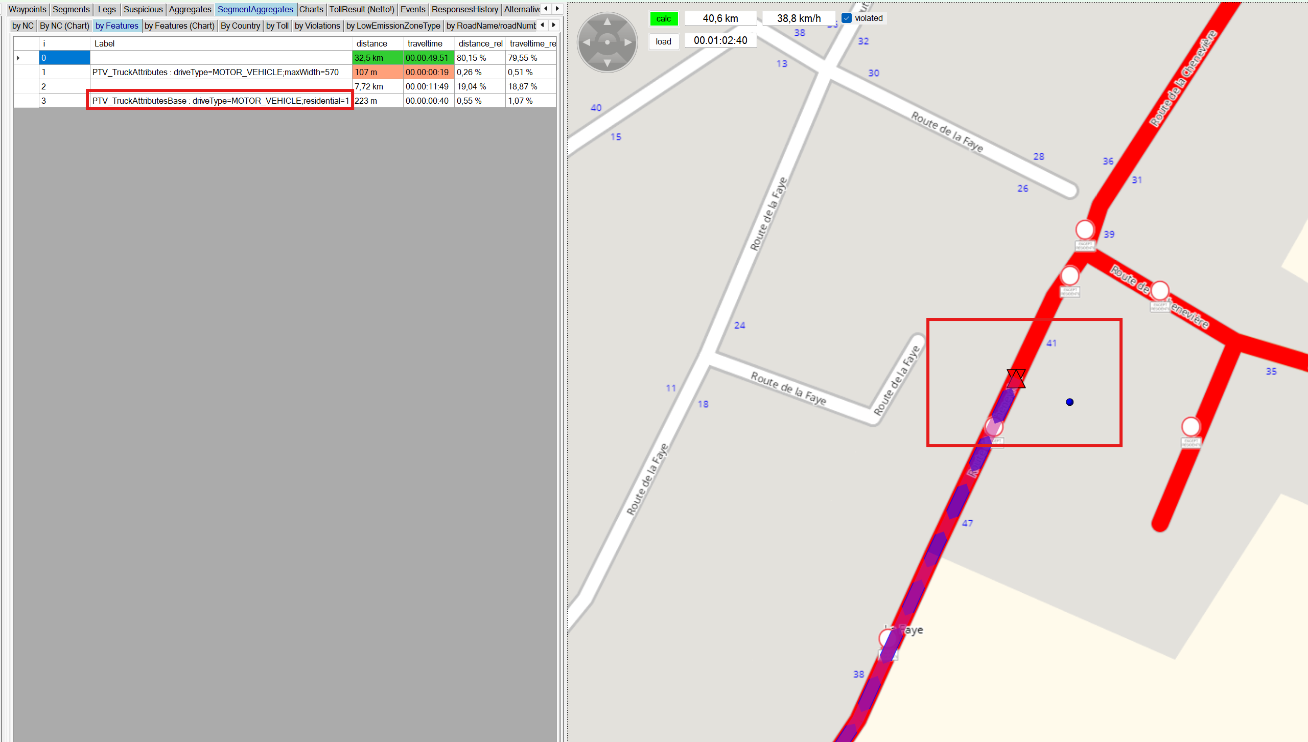

I made some test with the HERE map 2026.2H and it looks like the delivery location is placed in a "residents only" area.
As I cannot provide more details about this I kindly request you to create a helpdesk ticket so DEV can look into this.

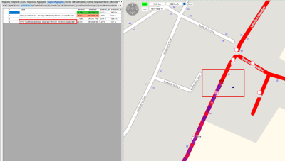

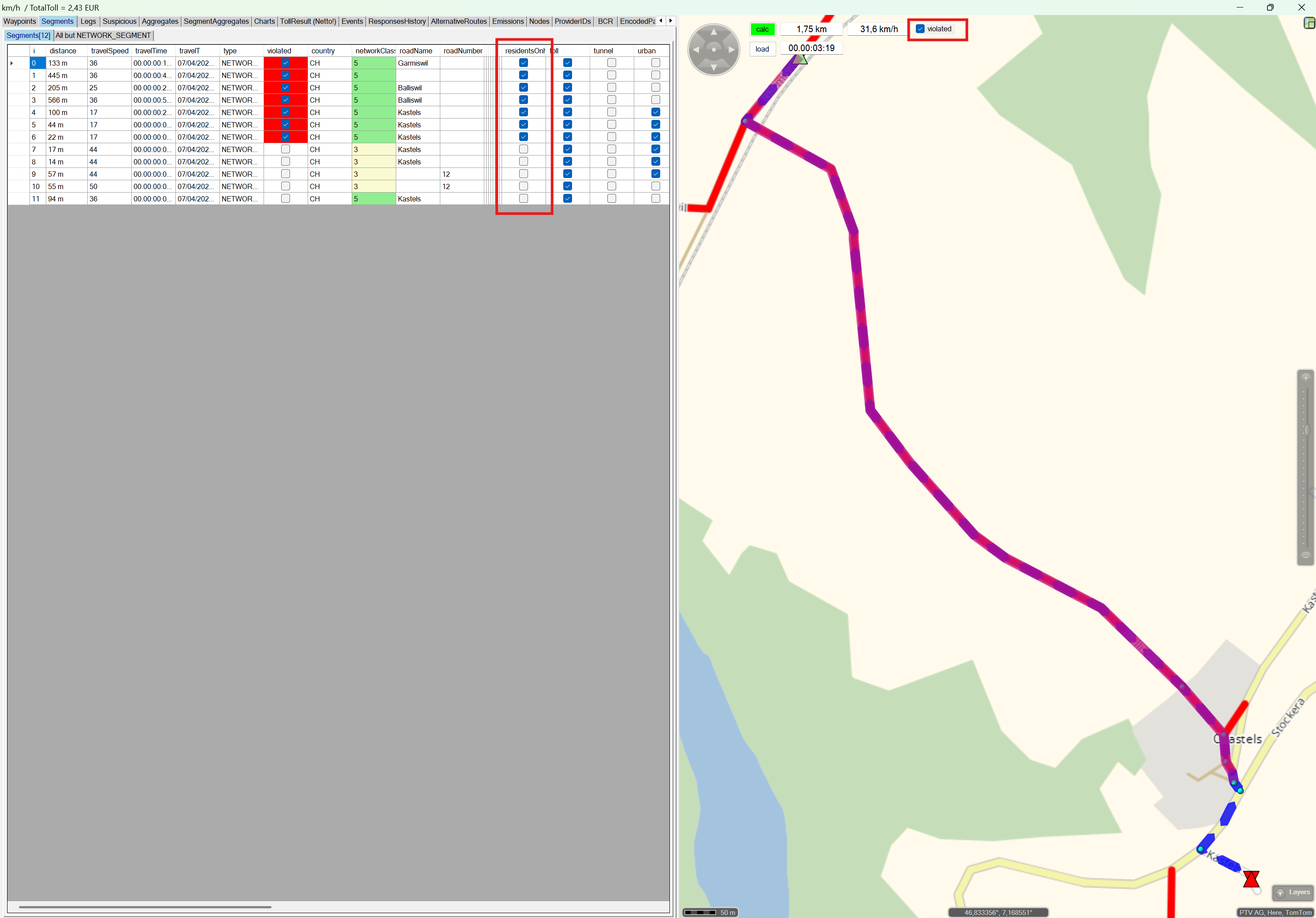

Posts: 3074
Re: Truck attributes consideration
Same cause: the segments are restricted to "residentsOnly"...
Screenshot based on xRouteToll2.
Unfortunately you can hardly visualize this with Developer tools - I used xRoute2 to replay this.
