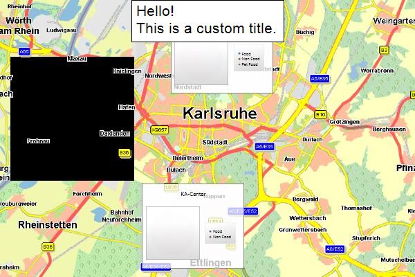

But the following code, does not work on start up!
The background is black because the Map control is still loading the background and label layer.
mapView.Printing = true;
mapView.UpdateLayout();
RenderTargetBitmap rtb = new RenderTargetBitmap((int)newSize.Width, (int)newSize.Height, 96d, 96d, PixelFormats.Default);
rtb.Render(mapView);
mapView.Printing = false;
I would like to export the Map control immediately after the control has fully loaded. (including background and labels)
The following lines do not ensure, that the control is fully loaded: :(

Yes, I'm using exactly this export function already.
But the problem is to find the point when the Map control is fully initialized.
I'm calling this function after the parent Form has been shown. But the Map control is still fetching the background layer asynchronously. Therefore, at this point this export function returns a black background layer. :(

OK, can reproduce that. The problem is not the asynchronous loading, the PrintMode-Flag disables async-loading + animations. The trick is the initialization directly inside the constructor before actually displaying the control. A solution would be this:
public Window1()
            InitializeComponent();
            Dispatcher.BeginInvoke(DispatcherPriority.Loaded, new Action(() => exportCustom_Click(null, null)));
As you see this shows the xMap images correctly, but not the pie charts, because these fade-in with an animation. But that's not a problem of the control itself. What would be interesting though is how to use the Map in a "headless mode" without actually attaching any window to it, so you could use it as pure rendering component.

I don't think the networks speed is a problem. I simulated modem speed with fiddler and didn't have a problem there. but i also had a black tile once. I also disabled animation explicitly in the constructor.
        public Window1()
            Map.UseAnimation = false;
I cannot reproduce it with that. If you still have problems, maybe an explicit initialization of the layers will help, see CustomInit sample here: https://github.com/ptv-logistics/xservernet-bin
