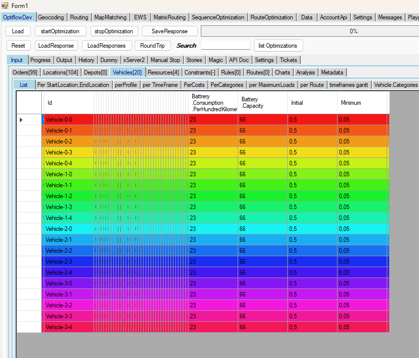

Homogeneous fleet: all vehicles show same charging characteristics. Of course you can specify individual characteristics per vehicle and also merge EV with non-EVs.

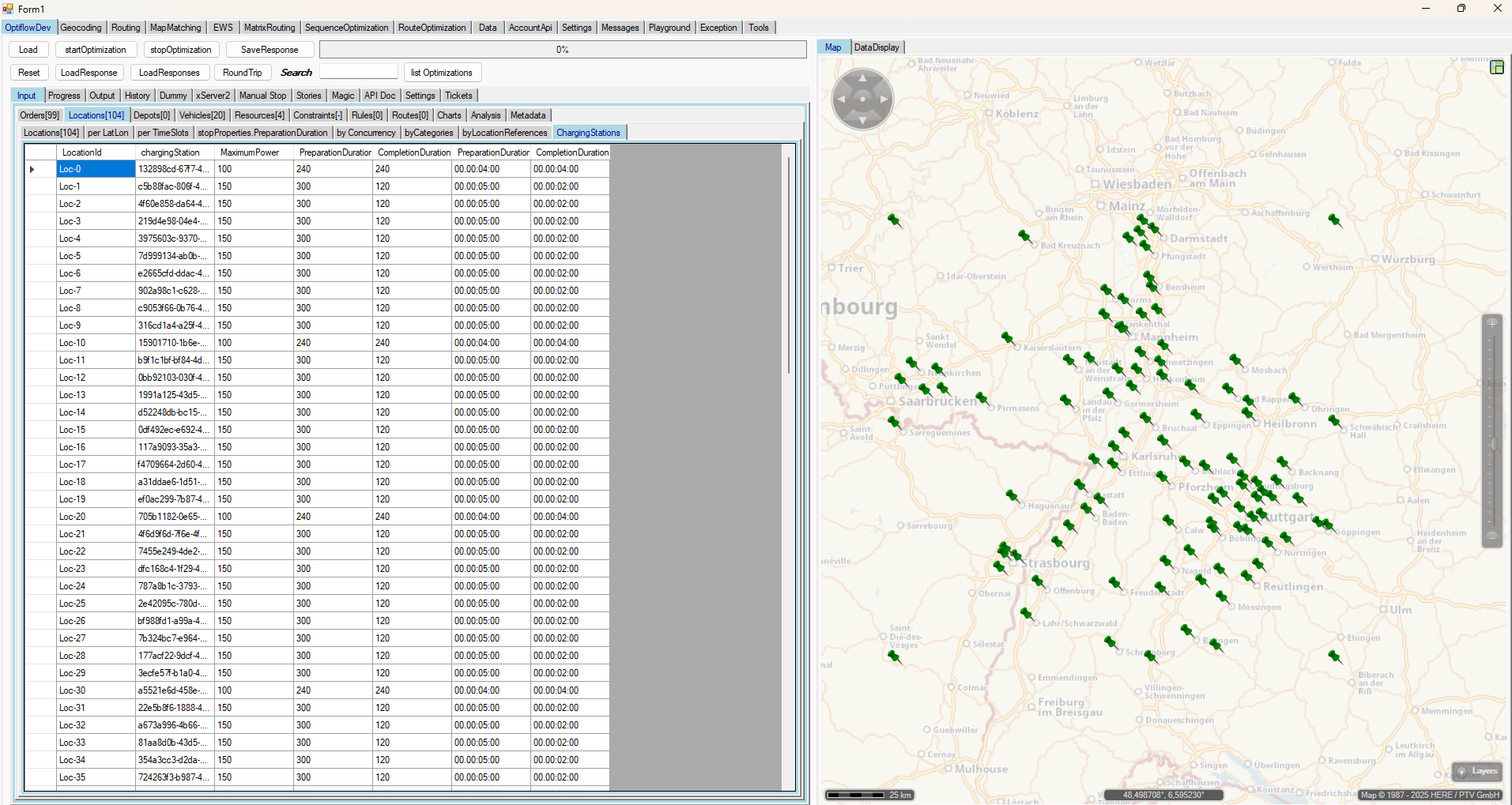

Same applies for the charging stations at the locations: They are all equally defined in my dummy but can be specified individually. You can even define multiple charging stations at one location
For the locations I defined
  • the maximum power
  • 2mins for preparation before the charging process starts
  • 2mins completion duration after the charging process
      "layover": "WITHOUT_ORDERS",
      "id": "Loc-0",
      "latitude": 49.01094692,
      "longitude": 8.408470917,
      "chargingStations": [
          "id": "132898cd-67f7-4ce5-8953-8eedbaa08adf",
          "maximumPower": 100.0,
          "preparationDuration": 240,
          "completionDuration": 240
The vehicles look like this:
  • Total capacity : 66 kWh
  • Initial state 50% loaded (=33 kWh)
  • Minumum state that requires charging: 5% (= 3.3kWh)
  • Consumption per 100km: 23 kWh
      "id": "Vehicle-0-0",
  "battery": {
        "capacity": 66.0,
        "stateOfCharge": {
          "initial": 0.5,
          "minimum": 0.05
        "consumption": {
          "perHundredKilometers": 23.0

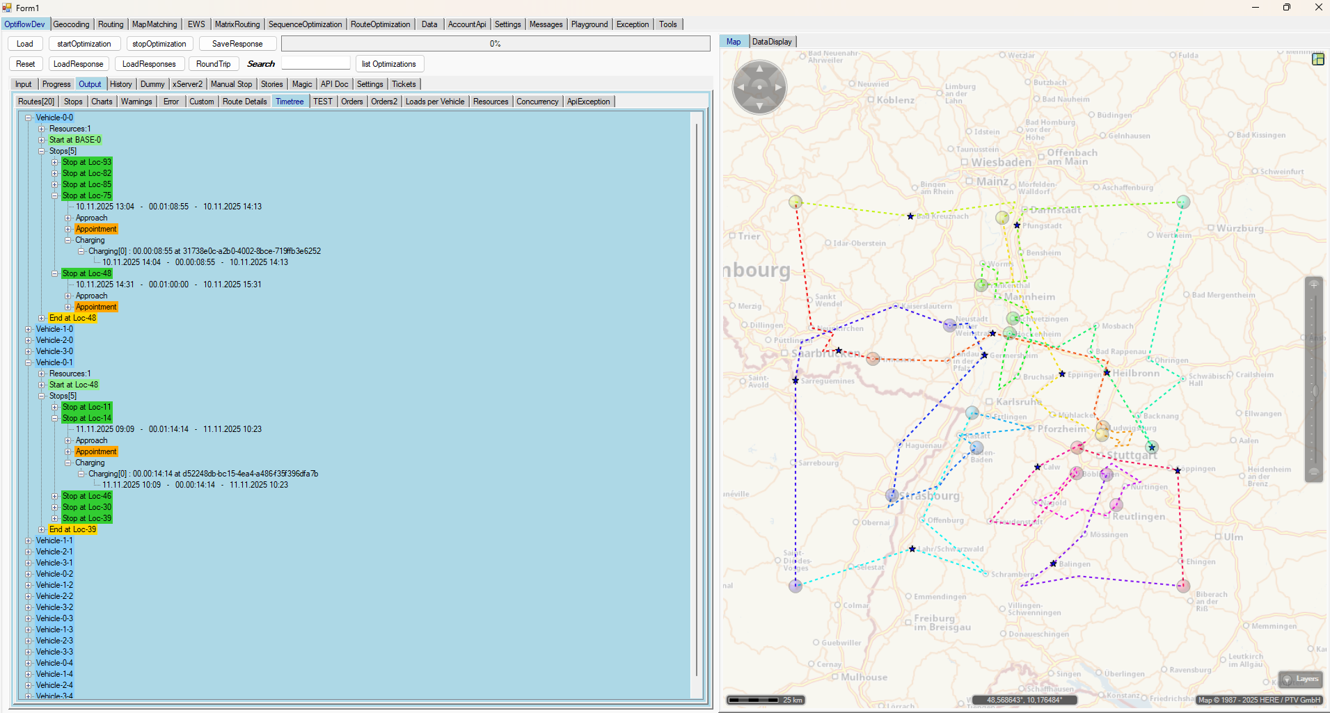

In the time tree I display the charging slot after the appointments. In the map a charging is displayed as a star symbol

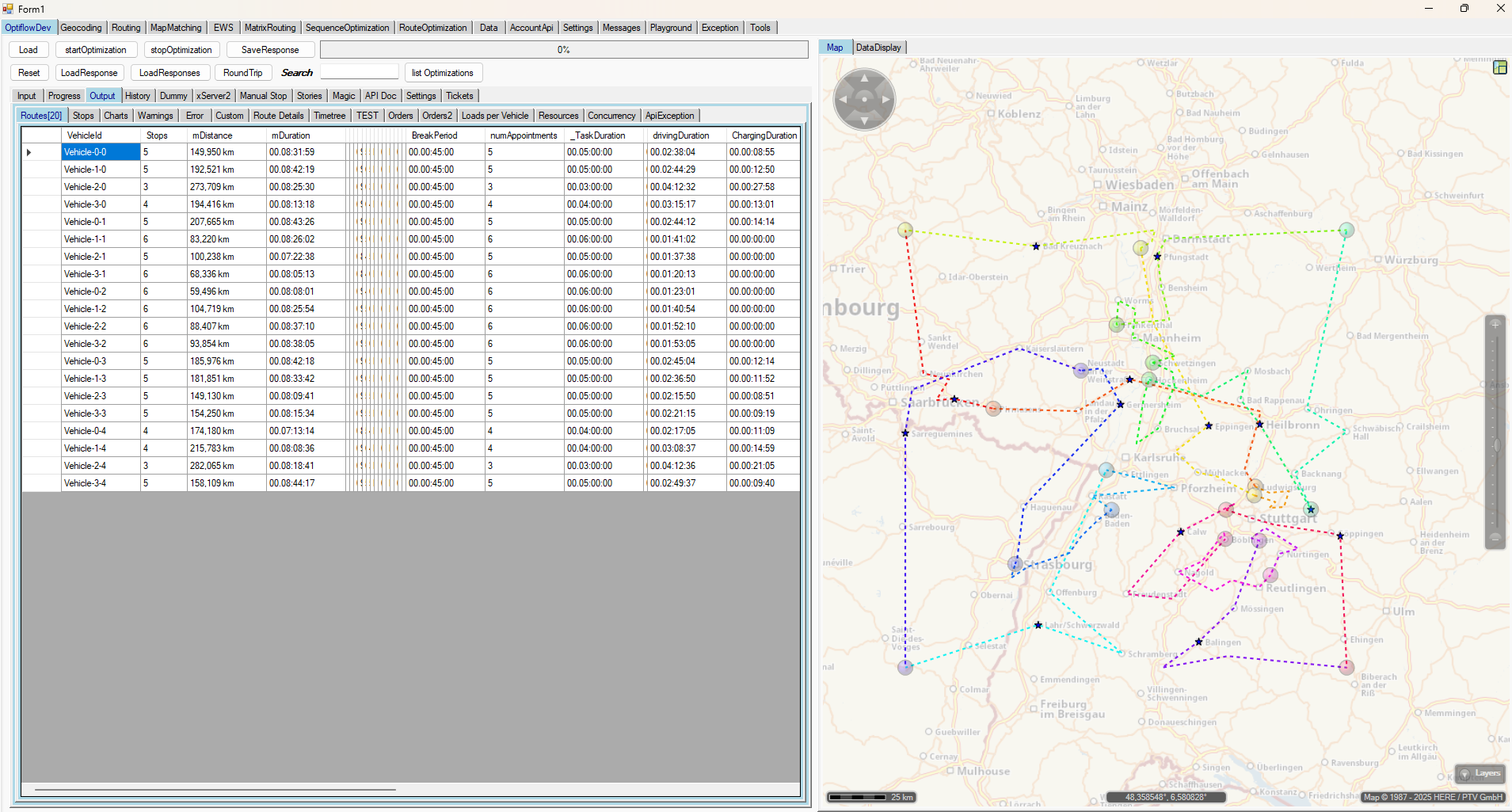

For each route I determine and return the charging time.

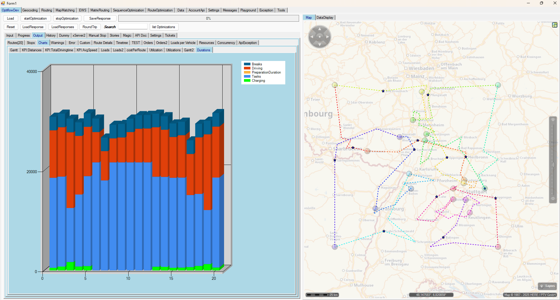

The chart shows the overall contribution of charging time in the routes.
