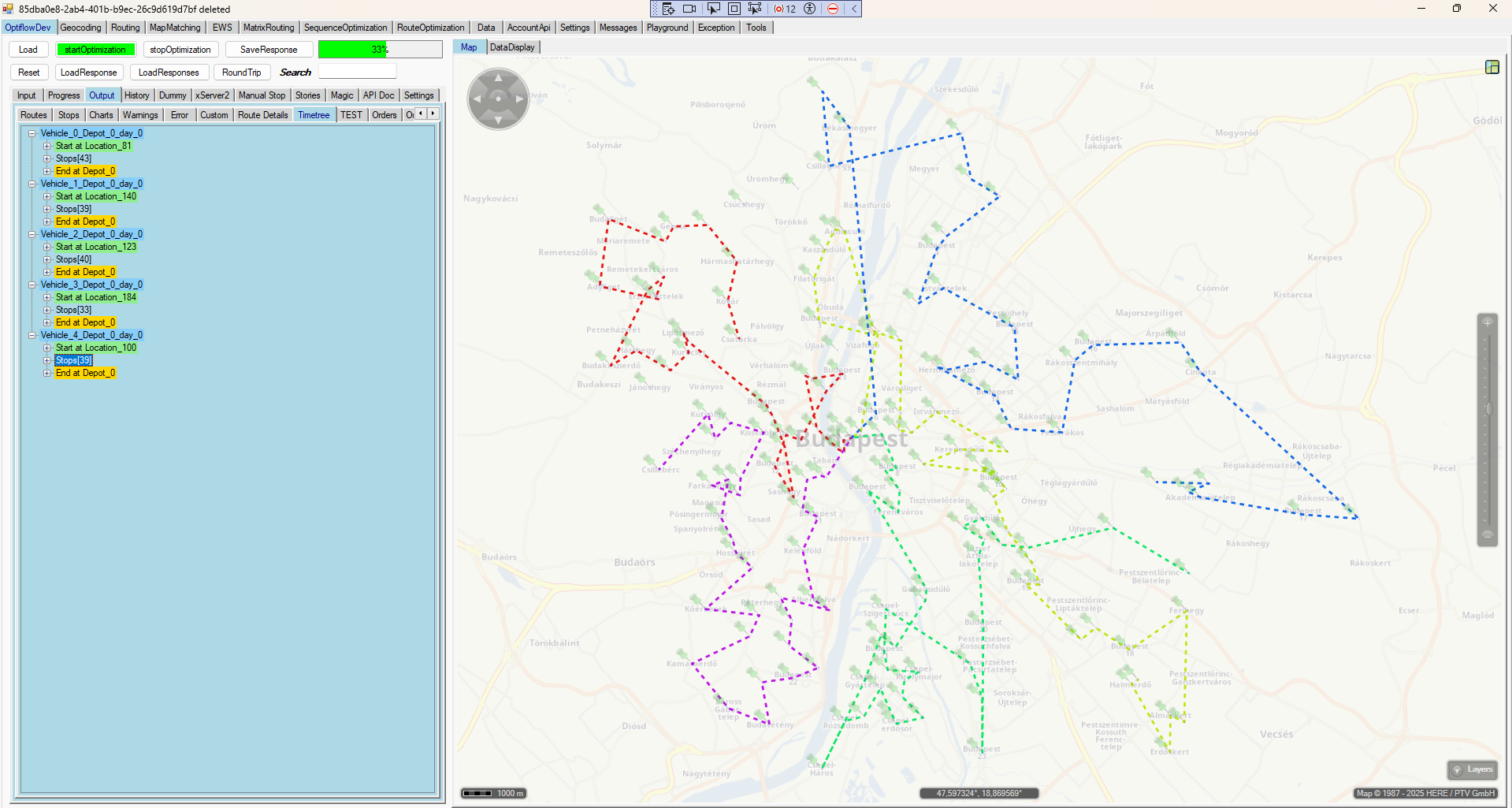

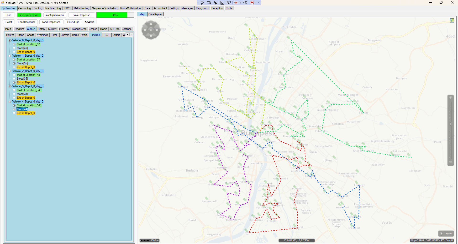

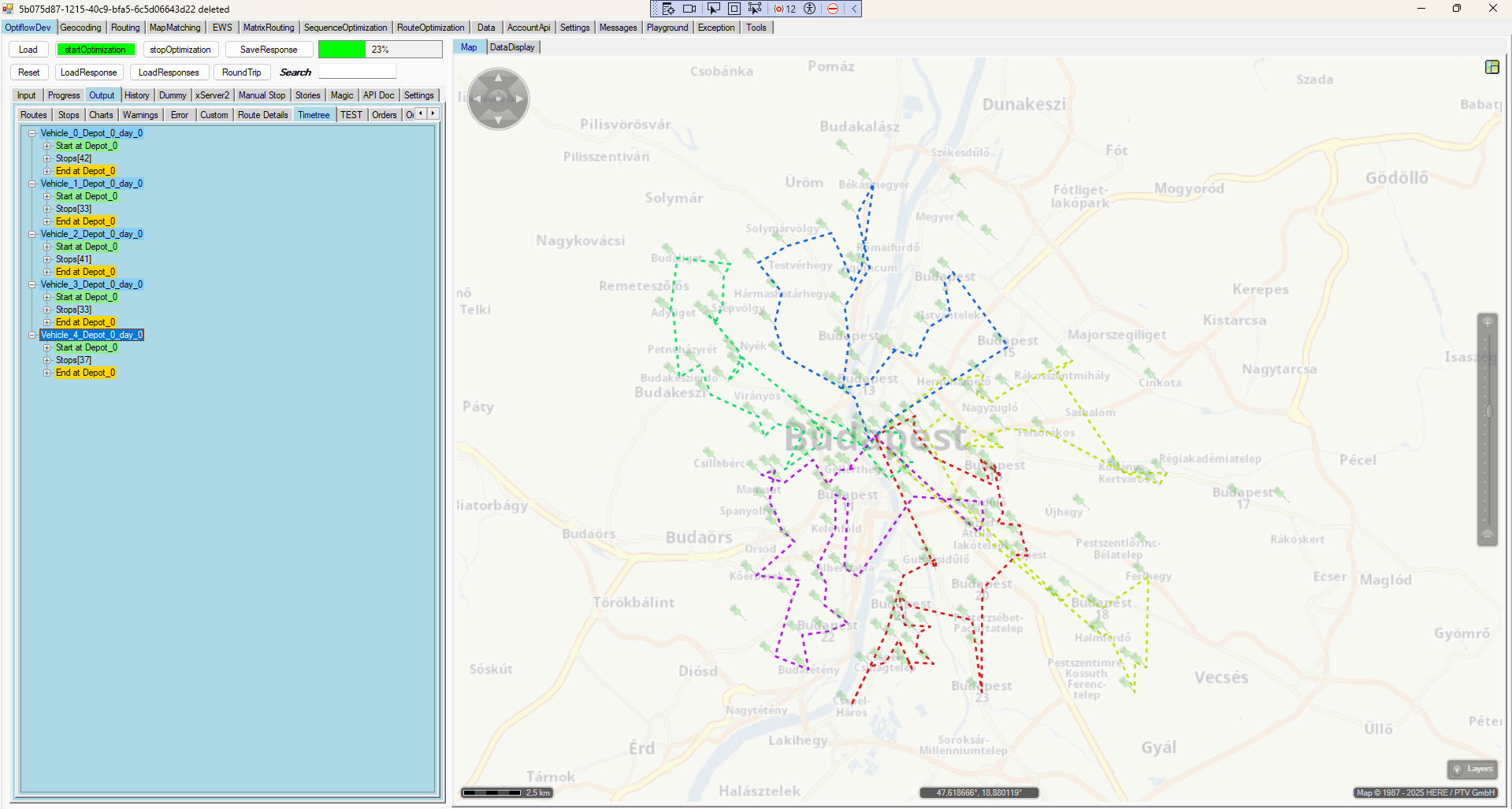

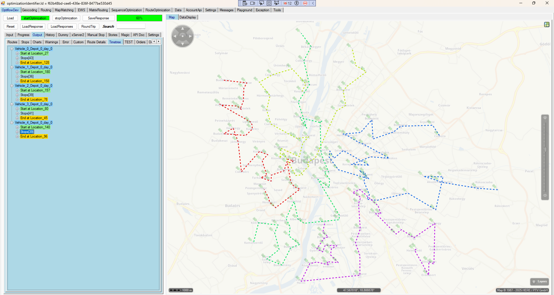

With these 4 scenarios I gathered the following results (left to right: roundtrip, openEnd, openStart, open both):

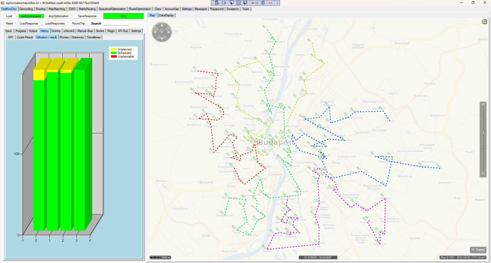

  • The utilization : you can see that the completely open structure allows the engine to schedule all the orders within the given timeframe as neither tour from a fixed start nor end  limits the sky.

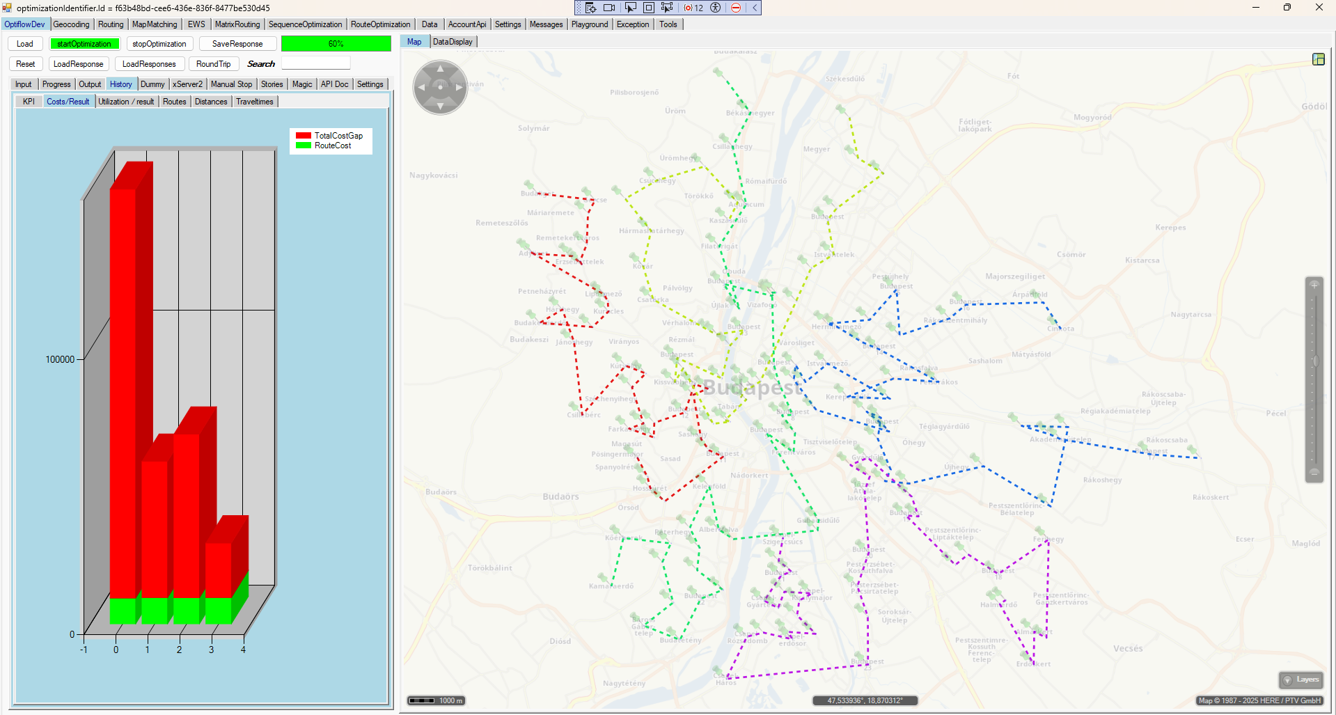

  • The total costs of the 4 results : in this example the total costs are extremely high compared to the others as not all orders haven't been scheduled and therefor contribute with high outsourcing costs.
