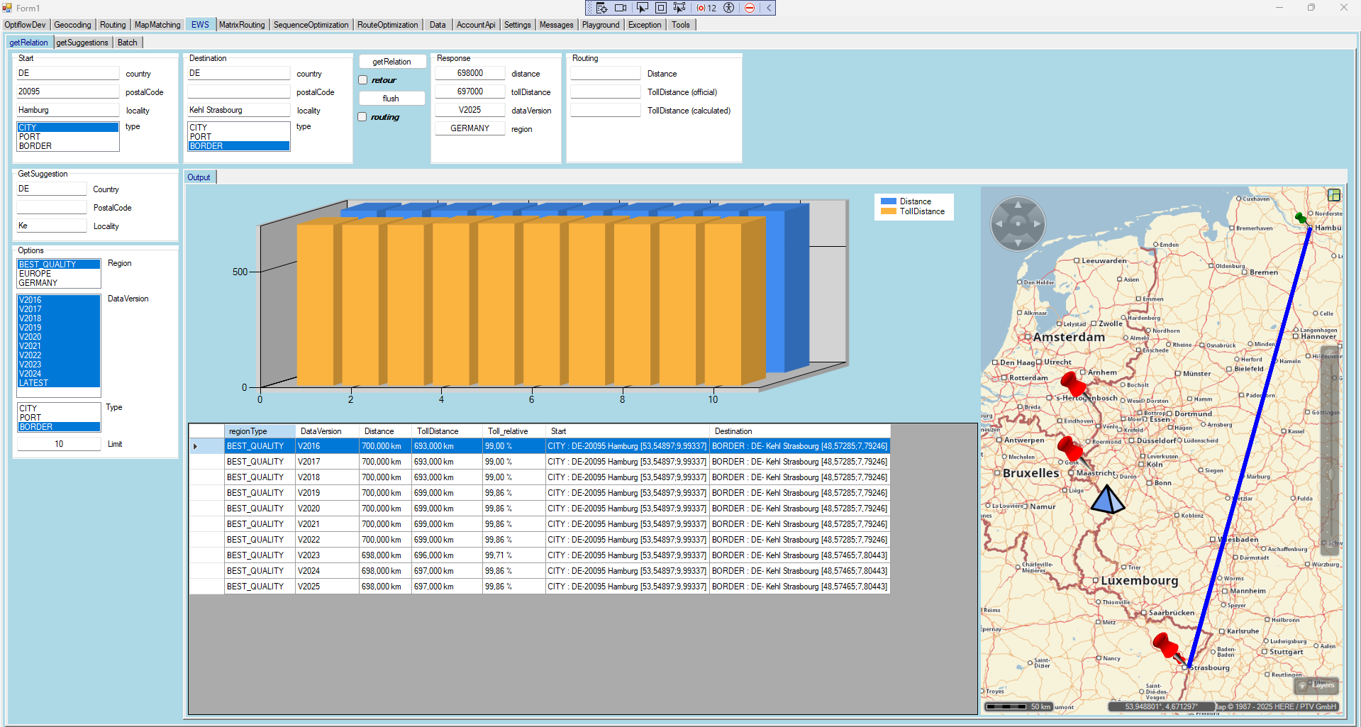

Let me try to explain the differences between the two APIs by starting to describe the usecase of the EWS (aka "Entfernungswerk Straße"):
  • The EWS is a huge database with a set of many thousands of standard relations within Europe. The main purpose is to gather distances for a standard truck profile which are then used for tender management, invoice auditing and credit note procedures, where different parties want to rely on the distances without the need to discuss vehicle parameters and routing options or geometries.
  • The primary keys to identify an EWS relation are not arbitrary coordinates but references to so-called nodes which could be based on
    • CITY names (no street or housenumber level!)
    • PORT names
    • BORDER crossings
    Furthermore a version reference such as v2016, v2017, ... LATEST is part of the primary key, too.

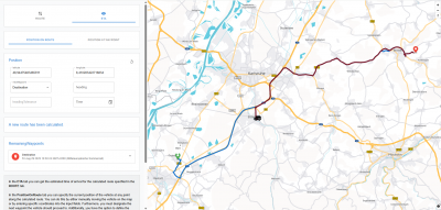

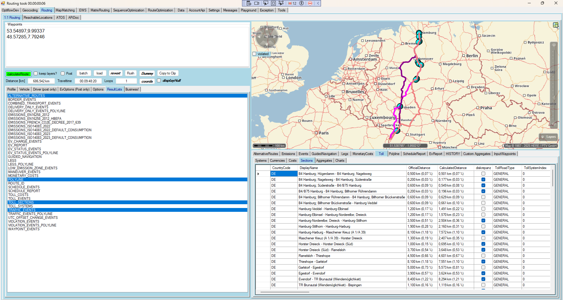

    • Detailed response elements such as toll details, CO2 emission, manoeuver lists

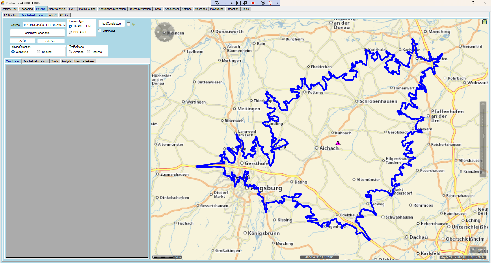

    All these features are reserved for the Routing API which by the way also offers completely different methods on top:
    • Corridor search / Reachable areas
    • ETA calculation (Showcase)
