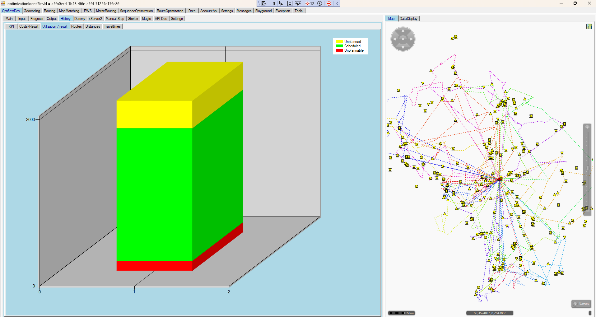

    Chart shows the evolution of the categories in a 2 minute planning (gathered the status every 6-10 seconds): RED contribution is stable. RED/GREEN changes with the time: more and more yellow is getting transformed into green. (sideinfo: the difference between solid and transparent is: solid means a change in the KPI)
So what can you derive from this?
  • Giving the algorithm more duration in the settings will definetly not convert a red order into a green/yellow one.
  • But there's a chance that increasing the duration / waiting longer will manage to transform a yellow into a green.

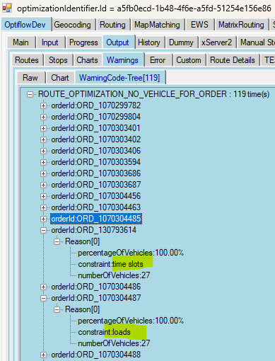

  • RED: if an order appears in the warnings with ROUTE_OPTIMIZATION_NO_VEHICLE_FOR_ORDER this means he is RED.
    BUT: at least today this is not an equivalence: it might happen that from a logical perspective should be seen as RED but the warnings do not report the order as RED.

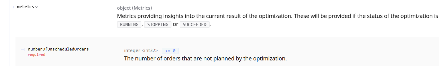

    But you can also determine the "number of yellow" by checking the metric's "numberOfUnscheduledOrder" (=yellow+red) and subtract the red one's (based on the proper warnings)

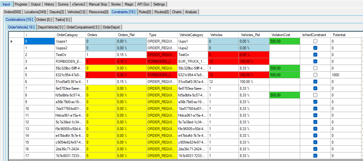

Here's how I implemented this.
  • Via client logic I determine the number of orders and vehicles that refer to a constraint (columns "Orders", "Orders_Rel" and "Vehicles", "Vehicles_Rel")
  • If a OrderVehicleConstraint provides "violationCost" it is a soft constraint, otherwise hard
  • For soft constraints I define what I call "potential": the additional coists that apply if the constraint is violated each time.
  • Then I compare the vehicles, orders depending on the type
    • line 0 / 1 : constraint useless - categories do not appear at vehicles / orders
    • line 2 : there's an order and no vehicle can serve it - will remain unscheduled
    • line 3 : there's an order that is forbidden for all vehicles in the fleet
    • line 4 : constraint doesn't apply to at least one order
    • line 5 : two orders define a certain prohibition. As this is a soft constraint the potential is 1000.
    • and so forth
