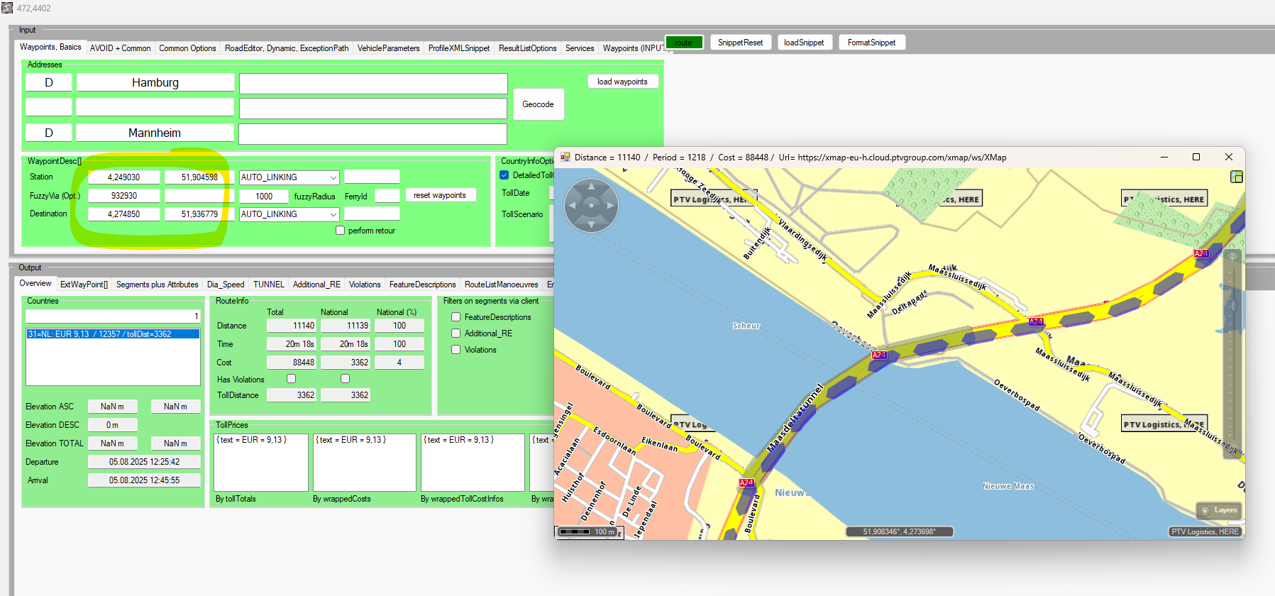

I have some features which draw maps on the road, and the tunnel does seem to be available.
As I cannot get any vehicle to use the tunnel, I am not sure how to investigate what is the issue. Is there anyway that I can verify that the tunnel is usable at all?
Might this have something to do with the 'TLN' version of the map?
Any advice on how to get the tunnel to be usable is appreciated.
