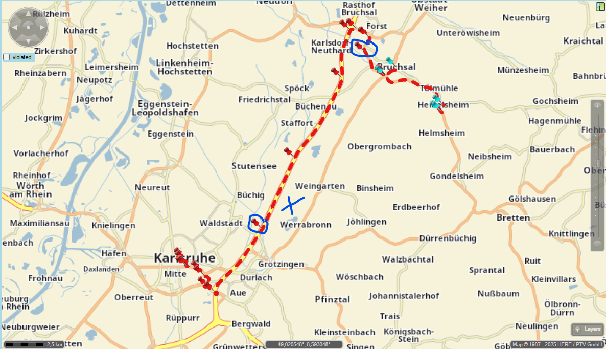

a partner wants to build an ETA calculation based on a guided navigation process in the backend (not on the mobile device).
We discussed an idea, but before we implement this with efforts I'd like to get a quick feedback about the approach or maybe a correction / alternative approach. Here's how we would tackle this based on xServer2 (PTV Developer offers a dedicated method getEstimatedTimeOfArrival / concept)
  • Avaliable Input
    • Vehicle's current (lat/lon) plus Timestamp (let's call it CUR)
    • Precalculated BCR file including multiple "silent via points" (SVP)
  • Output
    • Reconstructed route with proper ETAs for each waypoint - geometry should follow the precalculated BCR polylines / SVP
and here's the meta description of the process:
  • use a 1:N matrix call to identify the SVP which can be reached fastest : let's call it SVP*. Gather the required traveltime from CUR to SVP* and determine the arrival time at SVP*
  • identify the subsequence of SVPs that begins with SVP* (in other words: cut all SVPs prior to SVP*)
  • perform a track matching with this subsequence from SVP* to SVP.Last
What we do NOT know:
  • Which profile was used for the BCR calculation. Therefore we have to let the user pick a profile.
The doubts I have:
  • Selection of SVP* : could the dima lead to the wrong SVP backwards?
  • Are SVPs positions valid input for the track matching?
Sample image: <br />Waypoints: Karlsruhe, Bruchsal, Heidelsheim.<br />Red Pins: SVPs between Karlsruhe and Bruchsal (1st leg)<br />Cyan pins: SVPs between Bruchsal and Heidelsheim (2nd leg)<br />Blue cross: current position<br />Blue circles: candidates &quot;close&quot; tu CUR<br /><br />Though the lower blue circle is faster to be reached from an individual perspective, the upper blue circle is where I would expect the guided navigation to return to the route. Or not?
Sample image:
Blue circles: candidates "close" tu CUR

Re: REQ: ETA calculation process for guided navigation
For a usable output it depends how dense the SVP's are. If they are to spread out from each other you will get a lot of broken paths. In that case you are better off with a regular routing and use manipulate waypoints for the SVP's.
