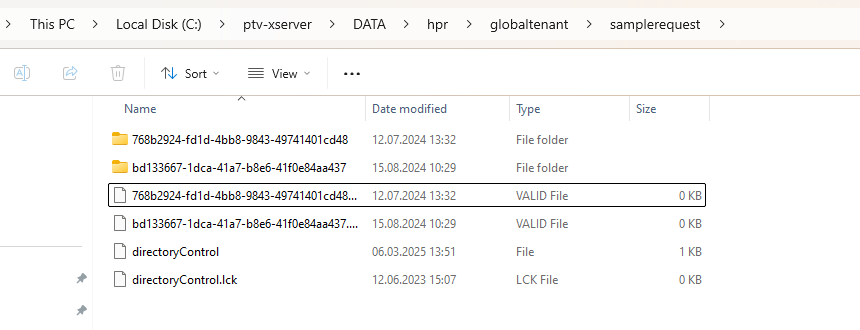

Here's the missing piece...
In the subdirectories of a user's HPR space there are
  • two files directoryControl and directoryControl.lck : these two files are used to detect whether something was changed. If the server is shut down you can delete these files: they will be recreated when the server is restarted.
  • per each HPR there's anbother meta file (*.valid) and a subdirectory named after the graph. While the subdirectory contains the the graph itself the "*.valid" file shows the garbage collection whether the HPR is
    • to be seen as garbage / to not appear in the list-statement
    • to be seen as valid / to appear in the list-statement
    If a HPR is deleted via an xData.delete call this *.valid file is removed and this causes the garbage collection to clean this HPR in the next iteration.
So here's what we assume:
  • In the customer's specific case either the surrounding directory structure based on tenant/scope is not proper or the *.valid files haven't been copied properly.
  • In some rare cases the HPR may not match the server's configured map version.
