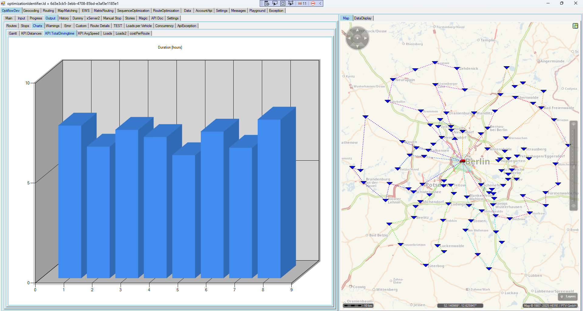

  • As time constraints apply the optimal solution in the default case is utilizing 8 of the 10 vehicles and the durations of the 8 routes comes along with 5 to 8 hours, so the longest route is 60% longer than the shortest one.
    routeDurationBalancing=0 for all vehicles (default)

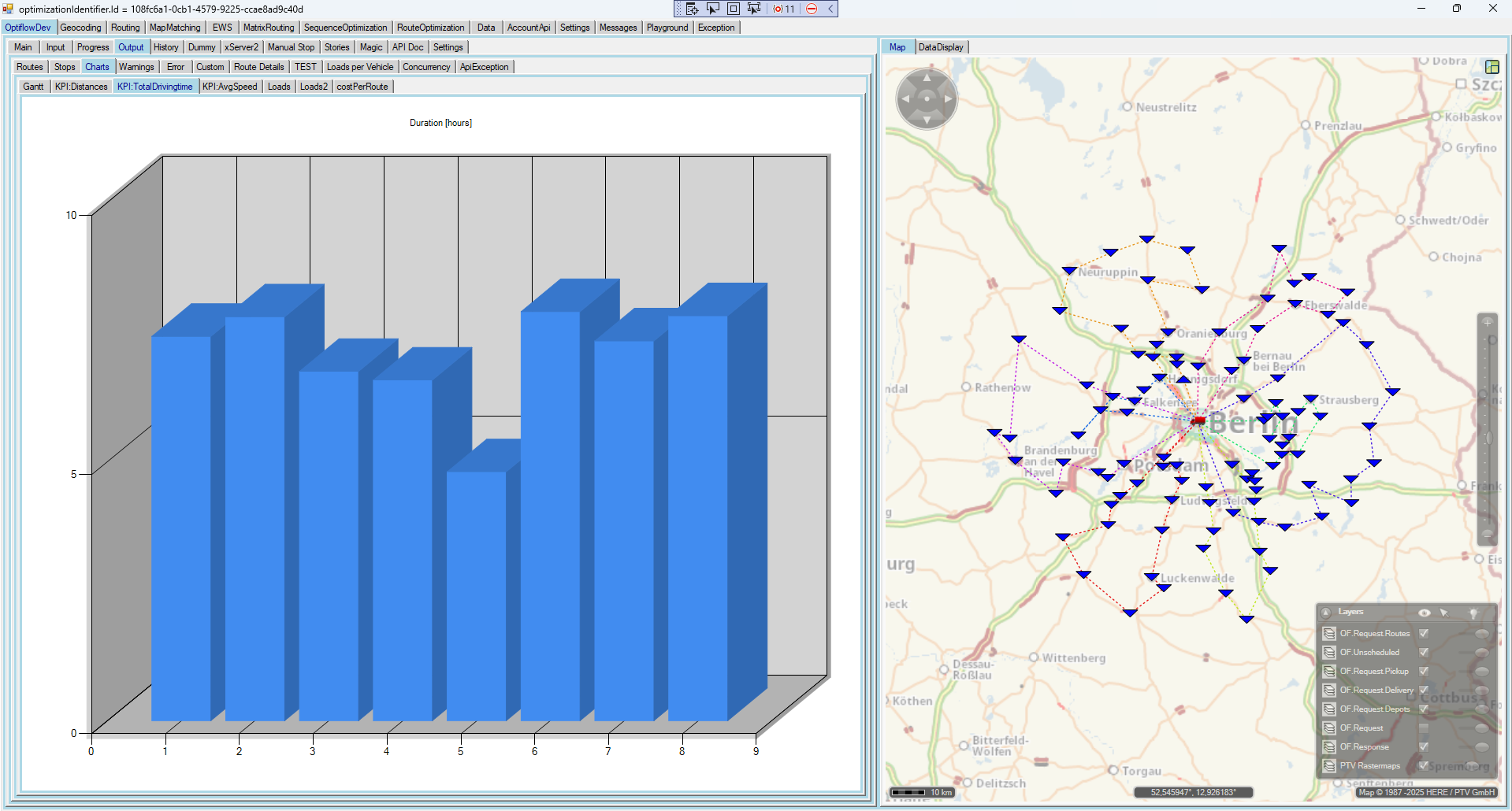

  • The new parameter manages to reorganize the routes to a 6-8 hours result, so the driver who has to serve the longest route works 33% longer than the one with the minimum duration.
    routeDurationBalancing=1 for all vehicles (invented in 1.13.0)

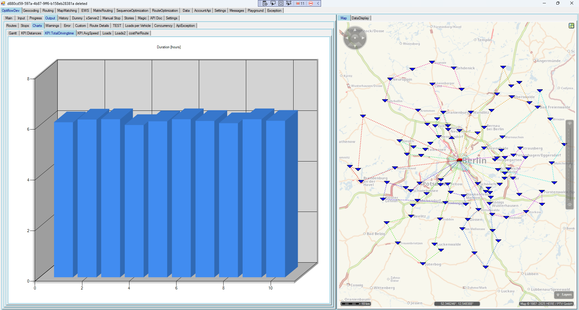

  • And here comes the difference if you compare this with xTour1:
    Additional client constraint: maximum tour duration set to 6:15 enforces utilization of the total fleet.
    • With BalancingParams in use the xTour1 would utilize ALL 10 vehicles and try to find an equal workload for all the drivers.
    • Optiflow determines the number of Vehicles needed and then balance the workload over all the drivers.
    • To simulate this in Optiflow I appllied a maximum tour length of 6:15 hours.
  • Be aware that balancing might increase the total costs - this is the price you have to be aware of!

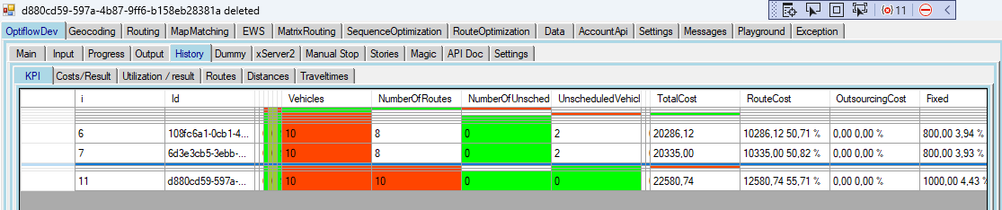

    Comparison of the costs of the three plannings.
