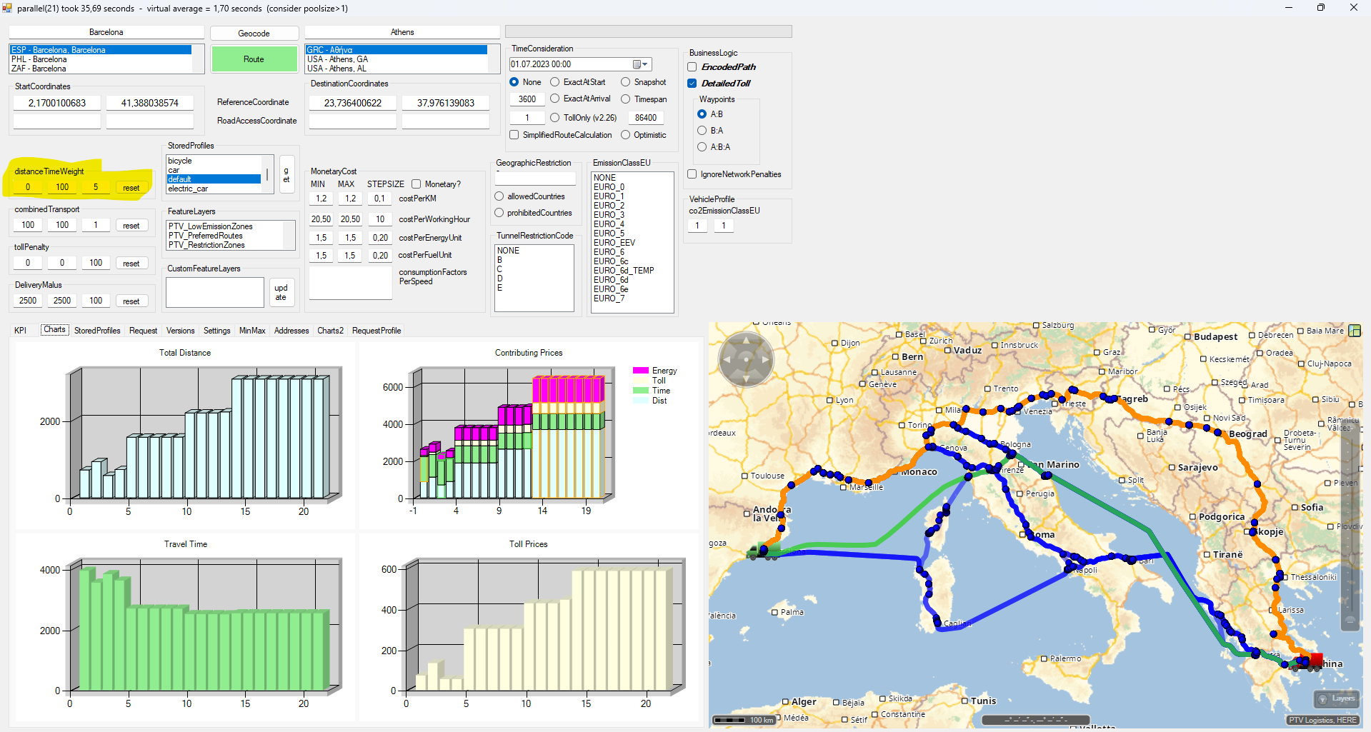

Just some more info about the linear balance between distance and time aka OPTIMIZATION and distanceTimeWeightiing... The map and charts show various routings from Barcelona to Athens. I iterated over the OPTIMIZATION = 0, 5, 10, 15, ... and you can see that depending on this value you can choose between a fancy cruise through the mediterranian sea (distance = few hundred kilometers, almost 3 days) or a scenic route through the countryside (less than 2 days but more than 3000km).<br />(xRoute2 based screenshot)
