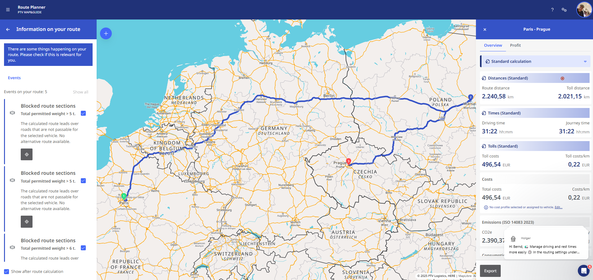

  • PTV MAP&GUIDE next generation

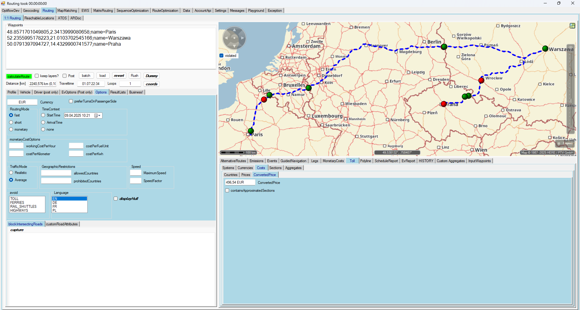

the demand is now to align these two solutions. The answer is: apply the following options in your Developer Routing API call
  • Base profile, e.g. EUR_TRUCK_40T
  • TrafficMode.AVERAGE
  • RoutingMode.FAST
Here's my sample call
  "waypoints": [
    "48.8571701049805,2.3413999080658;name=Paris",     "52.2355995178223,21.0103702545166;name=Warszawa",
    "50.0791397094727,14.4329900741577;name=Praha"
  "profile": "EUR_TRUCK_40T",
  "vehicle": {  },
  "options": {
    "trafficMode": "AVERAGE",    "routingMode": "FAST",    "language": "EN",    "currency": "EUR",    "speedFactor": 1.0
  "monetaryCostOptions": {},
  "results": [    "POLYLINE",    "TOLL_COSTS",    "TOLL_EVENTS",    "TOLL_SECTIONS",    "TOLL_SYSTEMS"  ]
Here's some example output for a route from Paris via Warschau to Prague
MAP&GUIDE next generation. Standard profile "40T Truck"  -  no further options available at this time (9.4.2025)
Developer Routing API based result - EUR_TRUCK_40T profile with explicit overriding of RoutingMode.FAST and TrafficMode.AVERAGE
