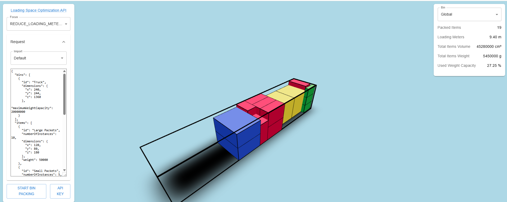

- Does the Loading Space API support side-loading? Are there any workarounds?
Our client's "must have" requirement is side-loading
- When stacking items on top of each other: how to ensure a proper gap between the towers?
Too much horizontal space between items affects stability and can cause collapse when truck will make emergency stop or turn
- Proper unloading sequences...I'll check the provided API call...
Unloading sequence settings quite often not working as expected and putting non-prioritized items on top of prioritized items. Our clients ship ... to Germany and there is not acceptable that client's forklift will deal with item relocation to get needed items out of the trailer and then put rest of items back.
REQ: Side Loading
- Posts: 3006
REQ: Side Loading
I just received some questions from an integrator who deals with Loading Space Optimization. Maybe someone from DEV can look into this and comment on it?
- Posts: 3006
Re: REQ: Side Loading
HI guys,
meanwhile the internal ticket (260905) is in progress - we assigned it to some colleagues who will look into your requirements and samples.
Let's wait for their feedback.
I have already been given an answer to the 2nd question:
For your information: if you want to replay a given JSON request with the Loading Space Optimization API you can use the showcase which allows you toWe do not suport the usecase with the gap between the loaded elements.
- process a JSON message
- and to display the output
- Posts: 3006
Here's some feedback about the side loading topic:
- Side loading is currently not supported by the Developer Loading Space Optimization API.
- Please check whether the xLoad2.packPositionedBins covers the specific need (technical concept / api doc)
