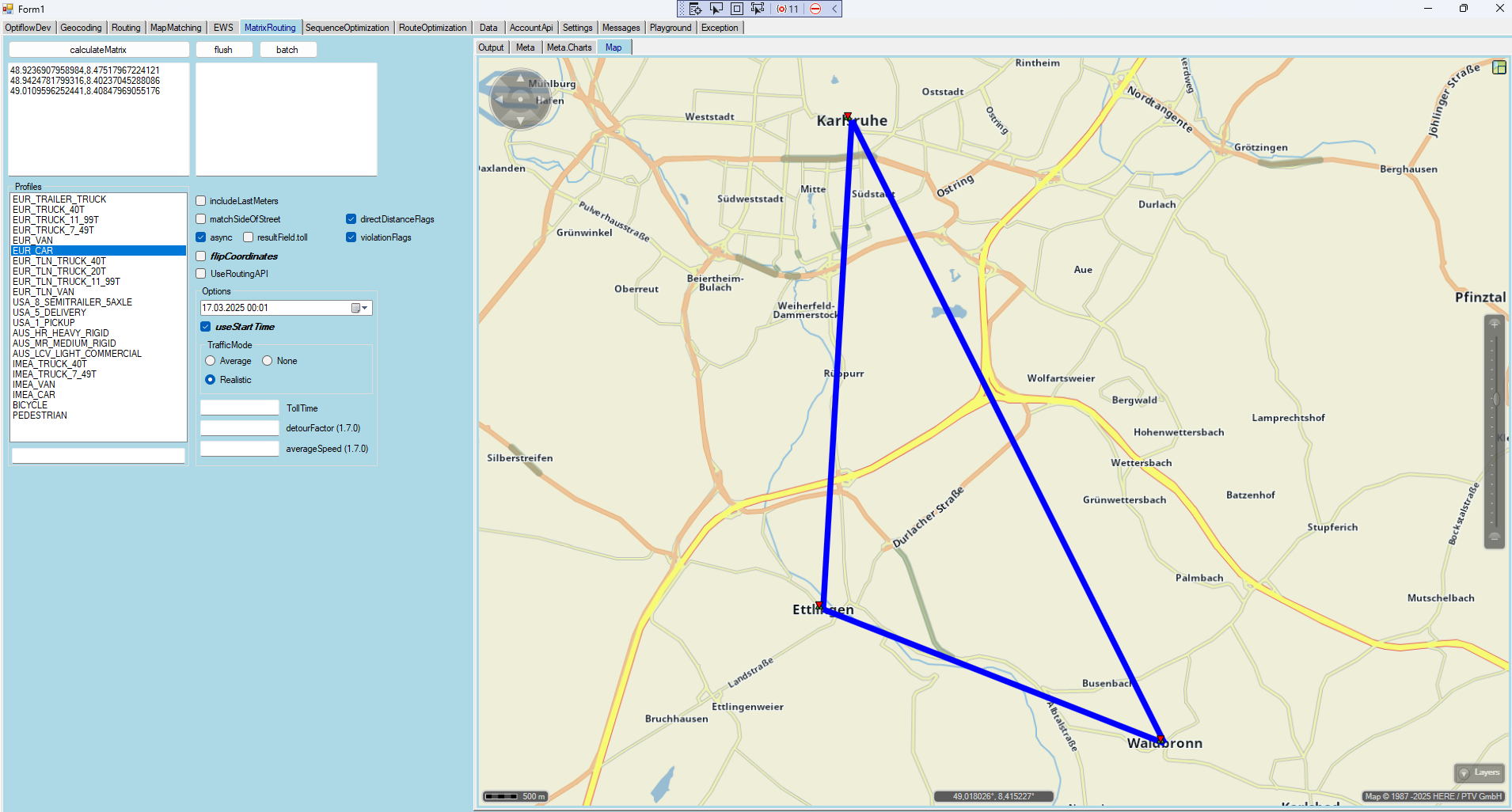

seems to be confusing sometimes I decided to prepare some fancy example.
Take your time to look into the charts to learn from the overview...
Coordinates are been based on <br />48.9236907958984,8.47517967224121<br />48.9424781799316,8.40237045288086<br />49.0109596252441,8.40847969055176

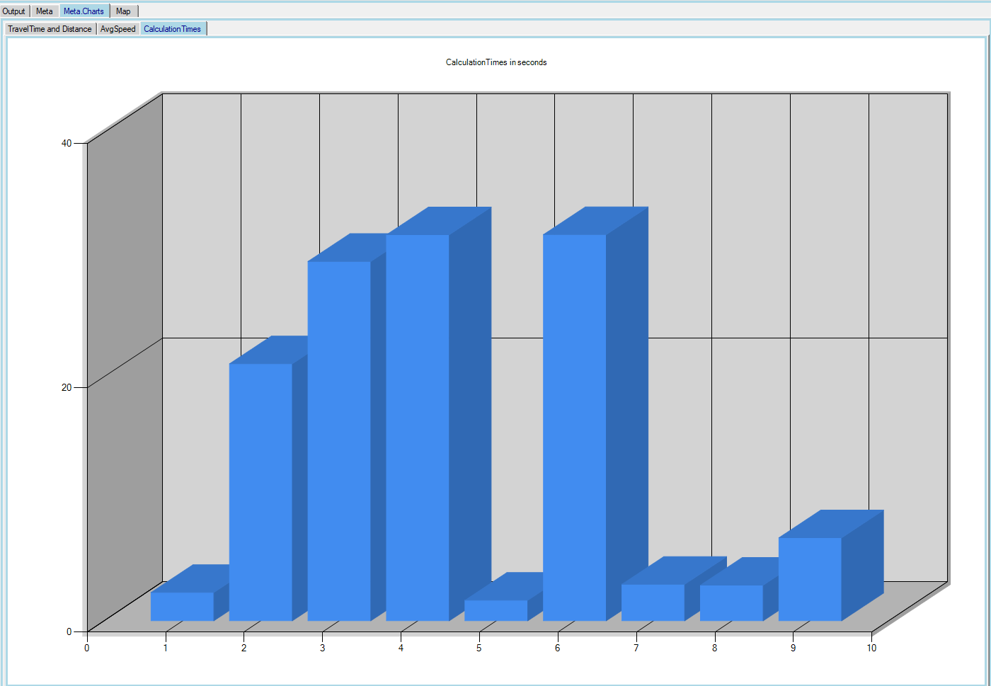

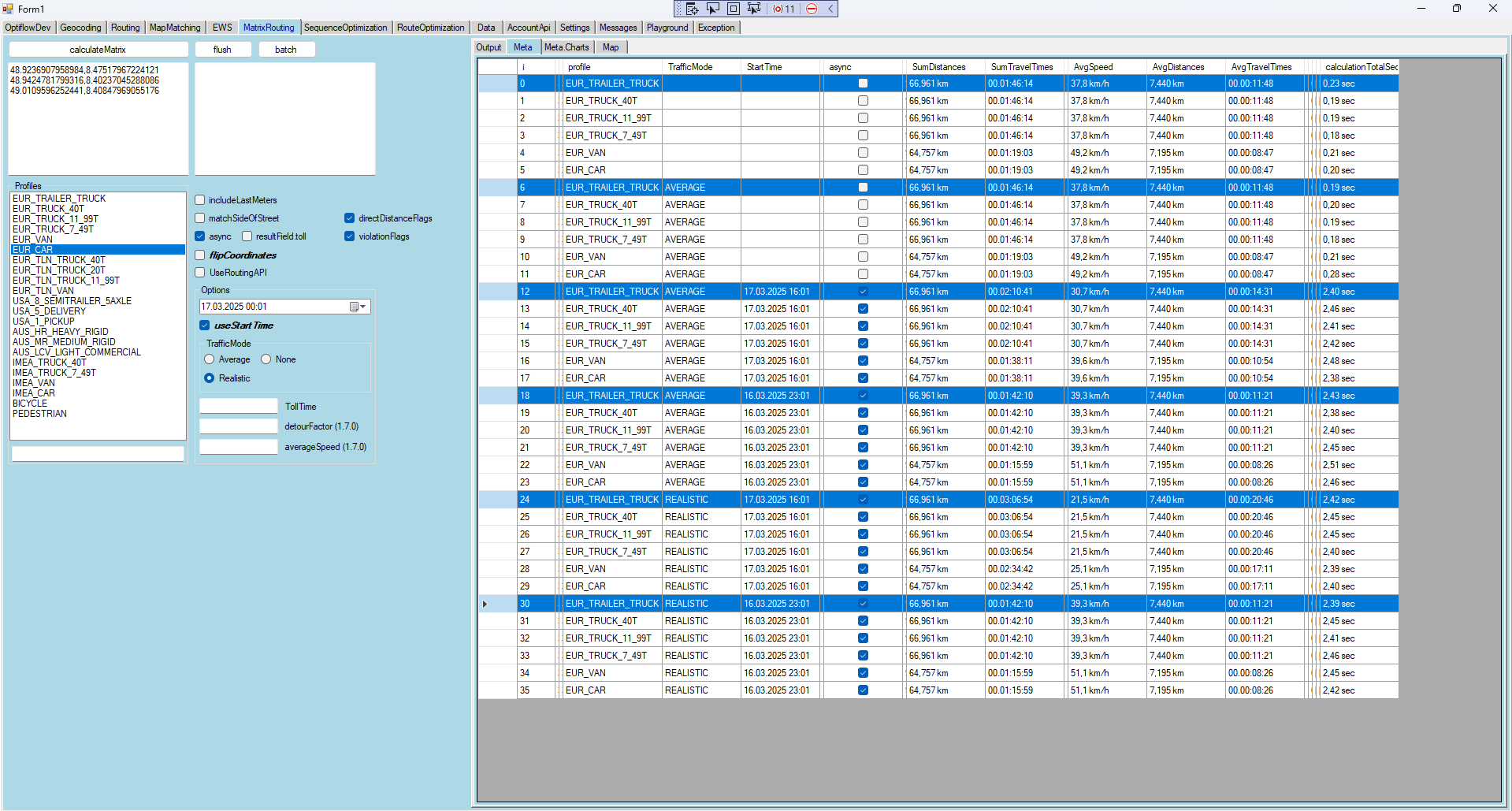

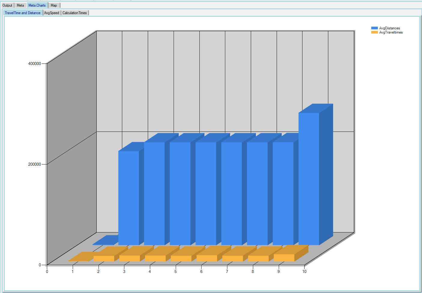

  • TrafficMode = null , Start Time = null
  • TrafficMode = AVERAGE , Start Time = null
  • TrafficMode = AVERAGE , Start Time = 16:00
  • TrafficMode = AVERAGE , Start Time = 23:00
  • TrafficMode = REALISTIC , Start Time = 16:00
  • TrafficMode = REALISTIC , Start Time = 23:00
  • TrafficMode=NULL produces equal results as TrafficMode=Average (if StartTime == null)
  • TrafficMode=Average, StartTime=NULL produces more relaxed results than TrafficMode=Average, StartTime=16:00
  • TrafficMode=Average, StartTime=23:00 produces more relaxed results than TrafficMode=Average, StartTime=16:00
  • TrafficMode=Average, StartTime=23:00 produces more relaxed results than TrafficMode=Average, StartTime=NULL
  • Average(16:00) produces more relaxed results than Realistic(16:00)
  • Start Time given or not has a clear impact on Calculation Time
Whenever a start time is given the calculation time is way higher than without a start time

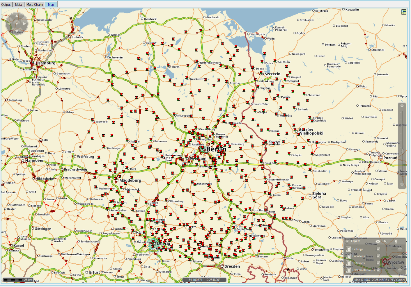

Sample dataset of about 500 locations in the wide area around Berlin

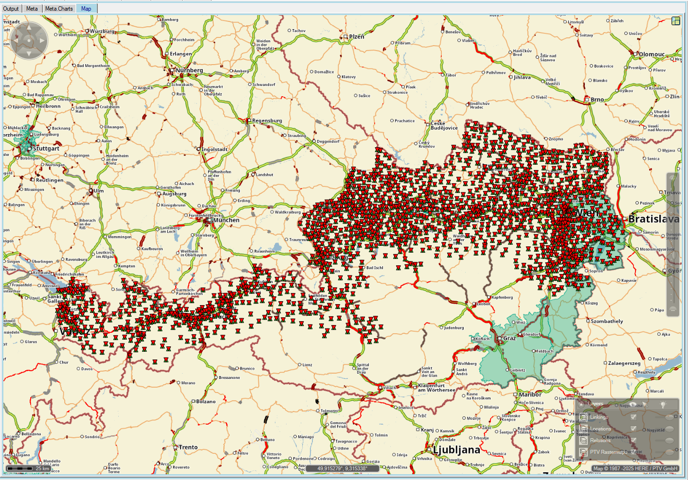

Sample dataset of about 2'000 zipcode locations in Austria
